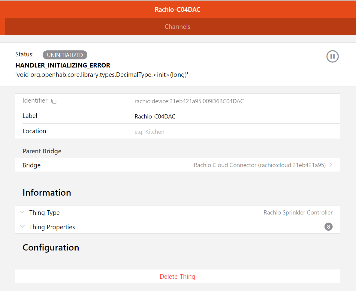

Hi @markus7017 . With the new 4.0 milestone out do you have any plans/time to update this binding to 4.0? It’s been solid for me for that last couple of years, but on 4.0 it won’t initialize the timer boxes or zones. They all get the following error:
2023-03-11 10:38:48.196 [ERROR] [nal.common.AbstractInvocationHandler] - An error occurred while calling method 'ThingHandler.initialize()' on 'org.openhab.binding.rachio.internal.handler.RachioDeviceHandler@7f35cae3': 'void org.openhab.core.library.types.DecimalType.<init>(long)'
java.lang.NoSuchMethodError: 'void org.openhab.core.library.types.DecimalType.<init>(long)'
	at org.openhab.binding.rachio.internal.handler.RachioDeviceHandler.postChannelData(RachioDeviceHandler.java:213) ~[?:?]
	at org.openhab.binding.rachio.internal.handler.RachioDeviceHandler.initialize(RachioDeviceHandler.java:94) ~[?:?]
	at jdk.internal.reflect.GeneratedMethodAccessor27.invoke(Unknown Source) ~[?:?]
	at java.lang.reflect.Method.invoke(Method.java:568) ~[?:?]
	at org.openhab.core.internal.common.AbstractInvocationHandler.invokeDirect(AbstractInvocationHandler.java:147) ~[?:?]
	at org.openhab.core.internal.common.Invocation.call(Invocation.java:52) ~[?:?]
	at java.util.concurrent.FutureTask.run(FutureTask.java:264) ~[?:?]
	at java.util.concurrent.ThreadPoolExecutor.runWorker(ThreadPoolExecutor.java:1136) ~[?:?]
	at java.util.concurrent.ThreadPoolExecutor$Worker.run(ThreadPoolExecutor.java:635) ~[?:?]
	at java.lang.Thread.run(Thread.java:833) ~[?:?]

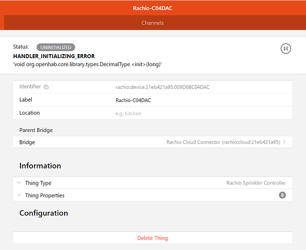

Hello, I have updated to 4.0.m2. Binding works, bridge is online. All things are visible by the binding but it can not start:
Can you check it?
@markus7017 I spent some time this morning getting this to compile for 4.0.0 (and backwards compatible to 3.2.0). You’re welcome to grab the changes from my branch if you’d like…
This jar should work on any OH 3.2.0 through 4.0.0 for anyone who is looking for it.
https://github.com/morph166955/openhab-addons/releases/download/rachio/org.openhab.binding.rachio-4.0.0-SNAPSHOT-24320db.jar
Hello, Many thanks for sharing. I have planned to do it as well as I’d like to use rain sensor tripped channel and it was not working. I have 4.0.0.M2 and all Rachio things are online now. Many thanks for the support!
