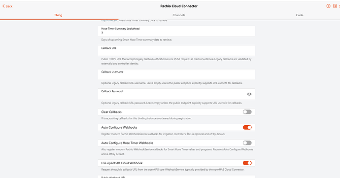

Dear Joe,
Can you try this version? Binding start up fixed. Legacy webhook should work for you and polling in that version.

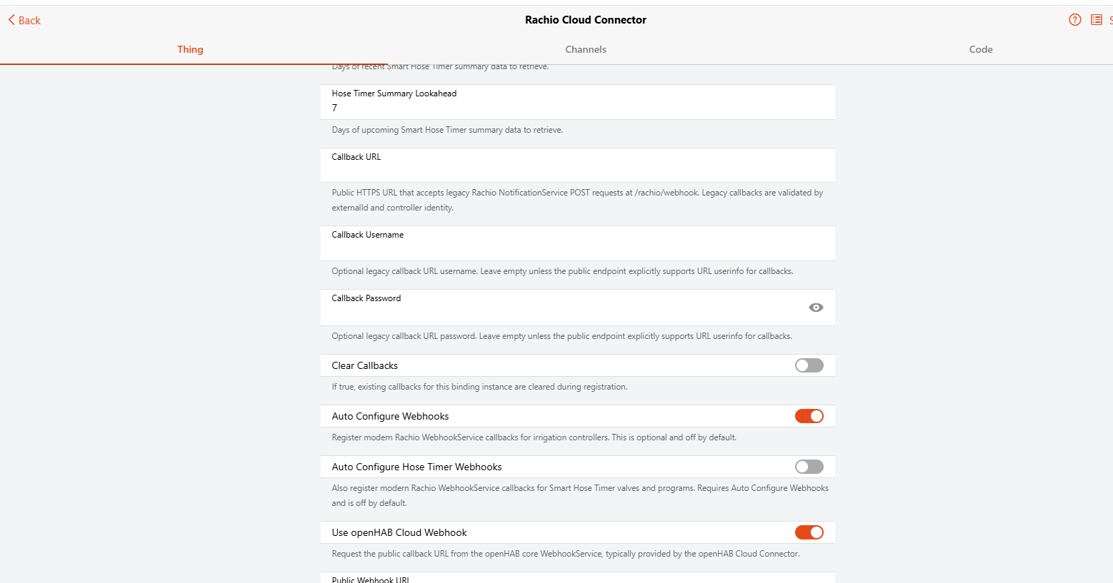

This is set of new webhook. For legacy webhook, you need to switch off all, fill callback url, user and password fields, and save. You can change and save when thing is active. Then you can deactivate, switch on clear callback, and binding will clear webhook registry. For normal use you can keep it off. We need it temoprary when webhook needs to re-register.
Done, the new version starts up fine for me with no errors now (to confirm I’m on 5.1.4 OH release). I haven’t used the webhooks.
If you set Callback URL: https://home.myopenhab.org/rachio/webhook
Your openhab cloud user as Callback Username and cloud password as Callback Password, legacy webhook will work. Now all weather items work and receive values in polling process. You can use almost full functionality of Rachio API with that version.When you upgrade to 5.2 then you wil be able to use new webhook, It works for me in that binding version.
