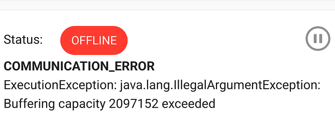

If I start the thing, I get an error.
Screenshot_2024-02-10-10-14-32-082_org.mozilla.firefox
This will be happening as your in a country with lots of stations that are hitting the max current capacity of the bindings/jetty buffers which appears to be 2MB.
I would change the show advanced config called filter to something like this as it will limit the stations to only the first 1700 that have a good click count. Anyone that downloads it from now on will have this change already done and wont need to make this change manually.
hidebroken=true,limit=1700,reverse=true,order=votes
This would show even less stations by removing any low quality streams below 192kbps (CD quality), but I would not do this, as you will throw away a lot of good stations as most will be at 128 and chat and sports ones probably lower.
EDIT: See readme file for examples that are up to date.
If you want to create your own custom filter, the options are listed here..
So ok.. With limit it is working.. Limit 100 and sort by clicktrend is more than enough.. :wink:
