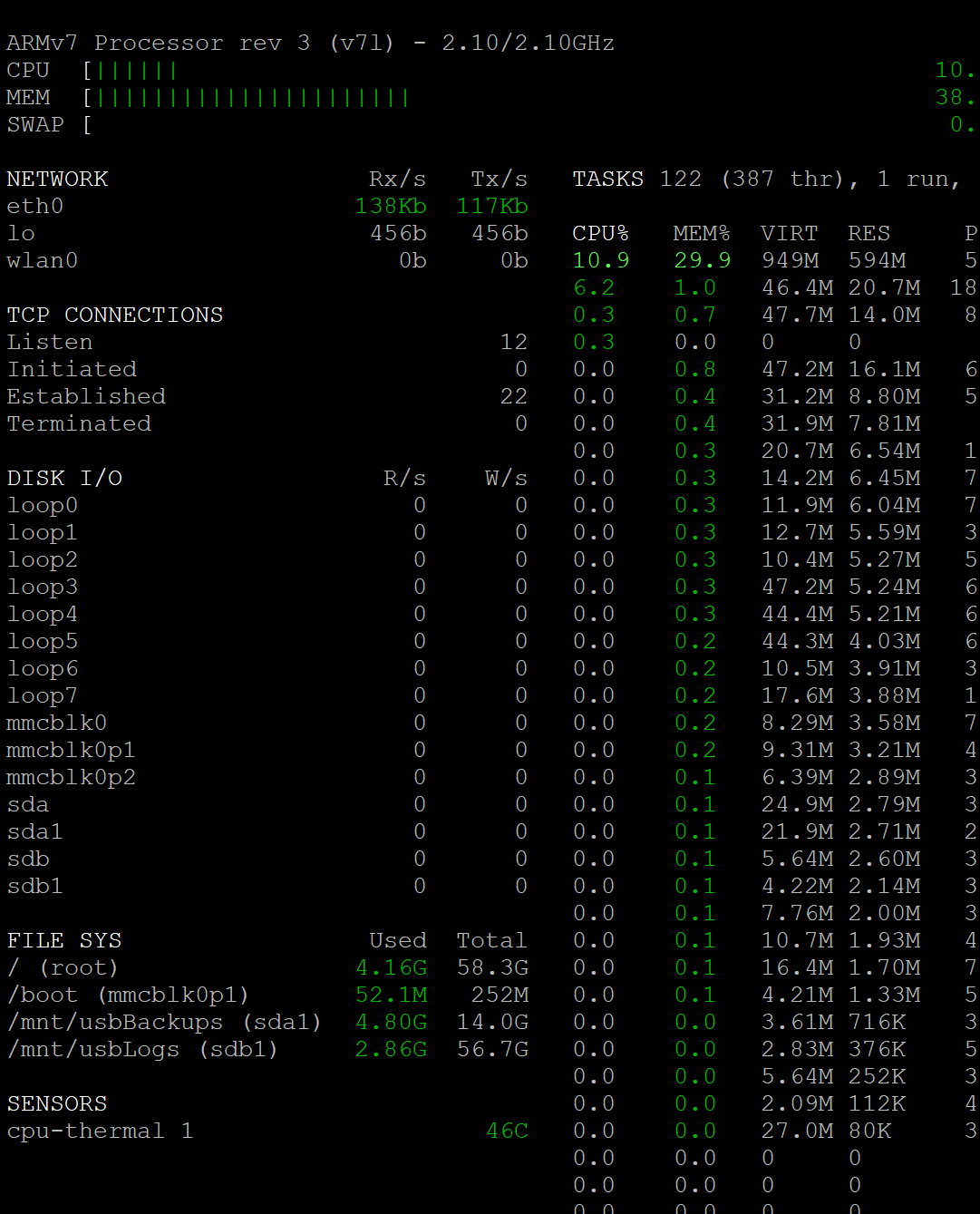

I’ve been running a pi4 with docker (mariadb, mqtt, grafana etc) for a while now at 2.1GHz and have now updated my home-auto pi4 to the same. Not had an ounce of trouble from them running at these speeds.
They both running quite a bit cooler than before (part pf the firmware update)
If for no other reason than the heat, it’s worth the update.
sudo apt update
sudo apt dist-upgrade
sudo rpi-update
** Reboot **
sudo sudo nano /boot/config.txt
Find the [pi4] section and add the following:
over_voltage=6
arm_freq=2147
Reboot :slight_smile:
