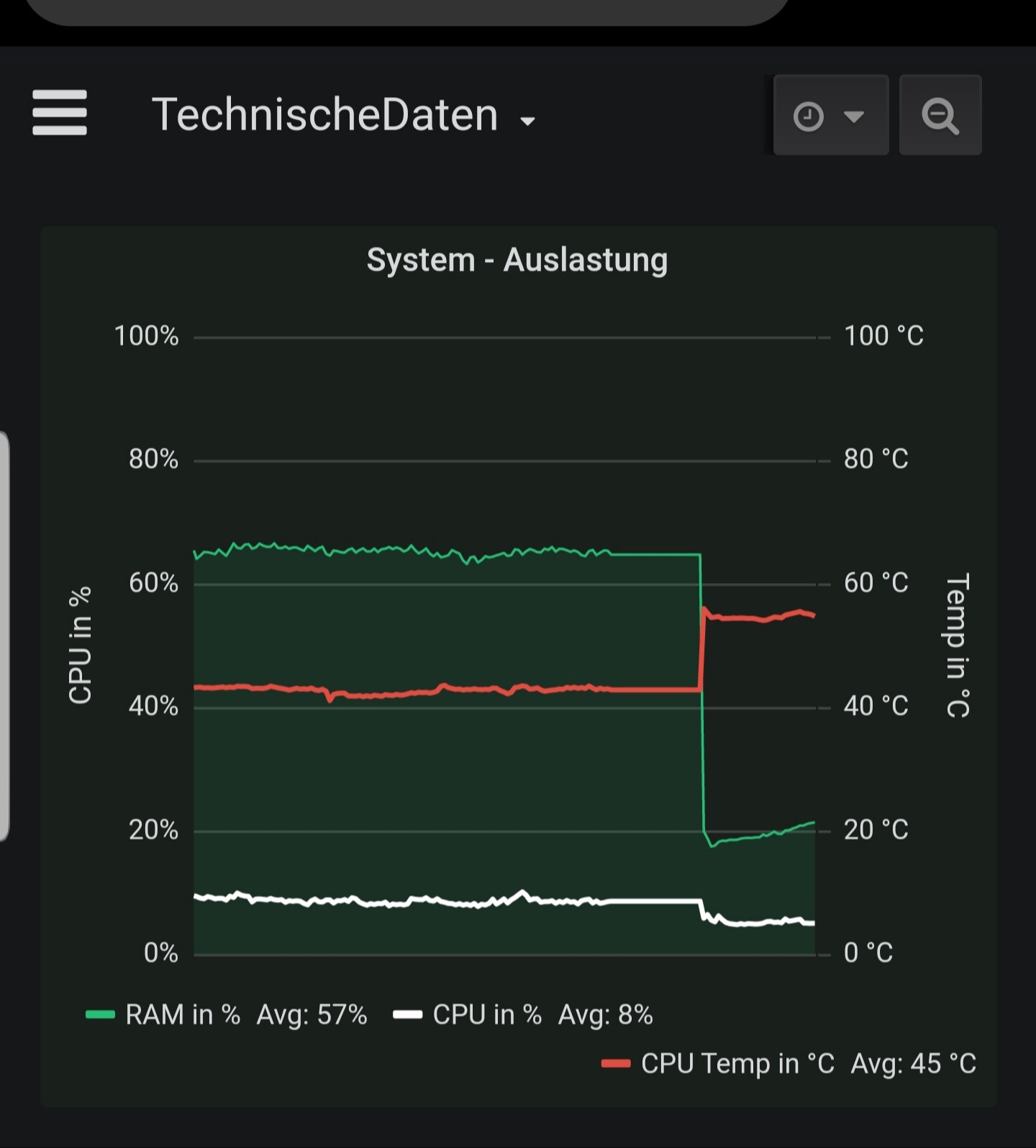

Just out of curiosity, do you notice performance improvemends ? If so in what ways ?
No one really tells if there is a ‘big’ difference between the rpi3 and rpi4.
Any Pi 2 or later provides way sufficient performance to run OH, so no, you could measure but you do hardly notice any improvements, and if so they’re not of relevance. Sufficient is sufficient.
It feels faster, so the pi4 feels faster when you swap pages in the Paper Ui or Habpanel.
According to grafana, the CPU has less to do.
I agree with this.
Yes, the 3 was sufficient but this just seems better. :slight_smile:
