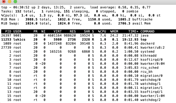

I am running openhab 2.5.0.M2 as a docker container on a rock64 and see the following output of my top:
Indicating 25% of my 4GB memory.
The settings are:
EXTRA_JAVA_OPTS=-Duser.timezone=Europe/Berlin -Xms400m -Xmx650m
Was running before 2.4.0 in a container on RPI3 and had from time to time (week, two) a freeze of the system with the same settings.
Looking forward how it makes it on the rock64, but it looks like it takes more memory as expected. The system and my rules are huge.
That’s the thing. It would take less than 1G total and maybe 500M resident if you omitted docker.
Which is 1G which is the RPi3’s total memory.
That’s really not a suitable application for Docker, it just makes things a lot worse.
to be specific, it’s not docker suitable application on RPI.
Docker OH is very ok to run on machines which are meant to be as servers
I might agree that RPI3 is not optimal running OH on docker. I exprimented with docker cluster, hoping getting some fault tolerance and failover. I was getting mixed results with cluster. Stepped back for production running a bare docker container on RPI3 and the utilities like ebusd, mqtt, influxdb, garfana, openvpn, landroid, glusterfs .. in the cluster. This worked perfect until the cluster and glusterfs burned my rather small sd cards (16GB), almost all 6 at all. Now moved to ssd 120GB. And finally moved the OH production to rock64 with 4GB.

Probably that Rock64 runs a 64-bit OS which consumes more memory because the memory address space in instructions is bigger. I happily run openHAB with Docker on a RPi3 (32-bit) and it only consumes 22% memory according to top.
It also looks like openHABian always uses -Xmx350m regardless of the architecture?
yes Xms and Xmx are static values I created an issue/ note to myself to adjust that in openHABian

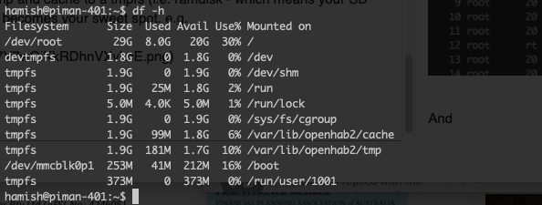

FWIW To throw my oar in, 1GB on a R-Pi just isn’t enough memory. Yes the JVM might be limited to 350MB, but that’s not actually how much RAM gets used.
The debate should be over whether 2GB or 4GB is the sweet spot. If you’re running stock, then 2GB is probably fine. But if you’re offloading tmp and cache to a tmpfs (i.e. ramdisk - which means your SD card will actually last longer) then 4GB becomes your sweet spot. e.g.

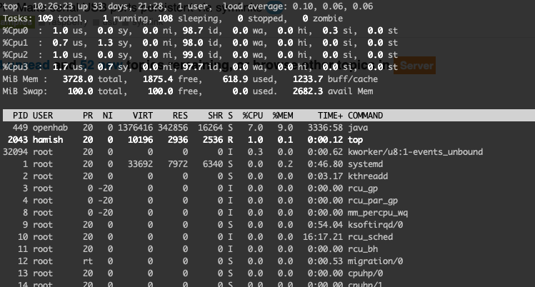

And
RAM isn’t just used for your Java heap…
