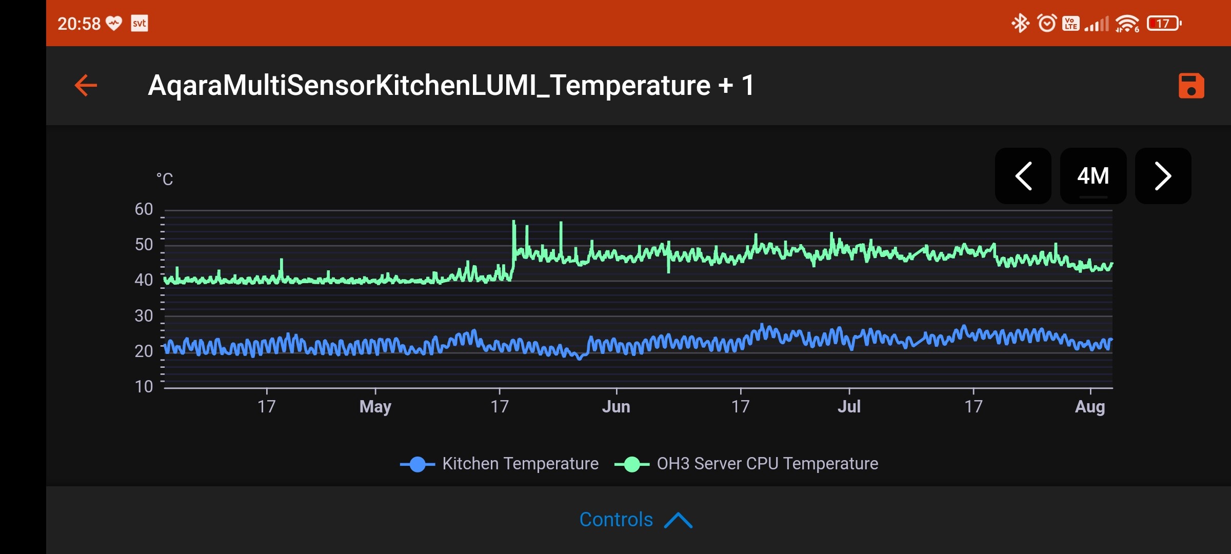

I run OH3 on a RPI4 4GB in an Argon One case. The fan setting is 10 percent at Temp > 55 °C. See below screenshot for ambient and cpu temp.

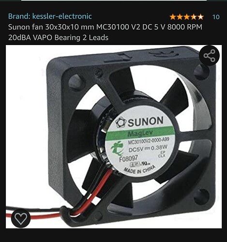

Update. I did replace the supplied fan with this
It gave the same airflow running at 10 percent as the Argon supplied gave at 100 percent speed. Hence, it is totally silent with the Sunon fan.
(Which obviously only started a few times during the last 4 months)

As your (Sunon) fan only ran a few times over 4 months (your graph tells that the OpenHAB load was higher the last 2.5 months) we may conclude that the Argon One case without fan was sufficient for the majority of the time. The critical points in time are the peaks on the white graph. Do you think that these were OpenHAB load bursts or were these gentle hills in a smoothly running process? I.e. in the first case you need your fan and in the second case you could do without
I was running the fan at 100% for temps > 40°C for the first months of the graph. But the case did cause a high pitched whine that was driving me crazy (working from home due to corona restrictions). I then increased the temp threshold, which basically means it was passively cooled, hence the jump in approx. 10 degrees. However, my ambient indoor temp is quite constant at 20 °C due to my HVAC system.
So, with a good heatsink (in my case the Argon One) you can run in without fan.
