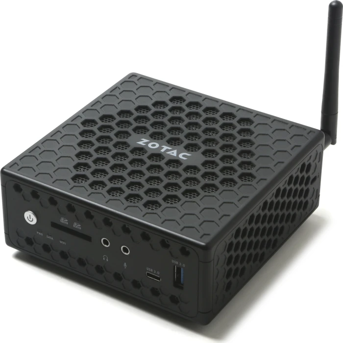

I’m thinking about using the following model:
https://www.zotac.com/product/mini_pcs/ci327-nano
If I am not mistaken, you could forward your logs to a NAS so nothing gets written to the SD card.Another option some people use is to buy an SSD USB stick which is far more resilient than plain SD memory.
