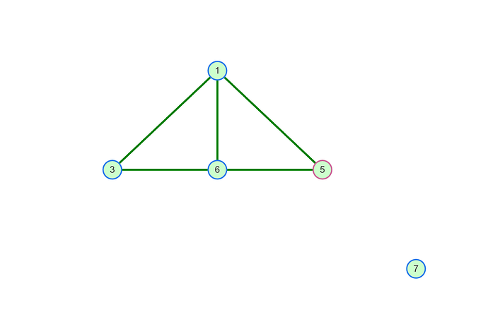

I’m running OpenHAB2 on a PI3 with Razpberry daughterboard and my z-wave network is not stable. I think this is because of the routing which in HABAdmin shows a bit weird and I am not able to change the routing. The following pictures show what I get in the Z-Wave network viewer
57
In this view:
1 - controller
3 - Lamp
5 - Door sensor
6 - PowerPlug
7 - PowerPlug
How to make 7 also have a connection to 1 or via 5 or 6 to 1, is there any way to force routing? (6 and 7 are my latest additions, an initially 6 was only routed to 1, only after a month it is also routed to 5 and 3)

The HABmin network viewer shows much more accurate info if you use the new refactored Z-Wave binding (and not the “standard” one).
I’m currently using the binding Z-Wave Binding binding-zwave - 2.3.0, what other refactored Z-Wave binding are you referring to?

No you cannot enforce routing.
Essentially, the software layer in the chips of each device handle this more or less autonomously and you have no influence on the order and metric of routes. But you should’t need this as the network chips take care themselves.
The only problem you might run into is when (used) routes are ‘destroyed’ because you move ‘neighboured’ devices out of range from each other (or do whatever has a similarly negative impact on radio connectivity).
What you do can do in this case is to enforce a node to update its list of (active) neighbours by selecting ‘heal node’ from e.g. habmin.
On binding startup, a network-wide heal is performed for all nodes.
The’re also a config option to a network wide heal to perform once a day, but it’s disabled in current binding (but available in the development version and likely in 2.4 when this dev binding is to replace the current one).

Ah ok, well maybe then my node 7 is to far away from node 6 which is at two times the distance to the controller away.
