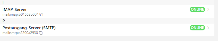

That’s correct, as you probably have configured a smtp thing for sending mail.
The binding has imap and pop3 things for incoming mail as well.
I have these things:
The code-tab of the IMAP thing shows the following (edited):

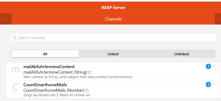

Under the channel tab I find:
There seems to nothing to configure?
Click on “Add Channel” (immediately below the message), select “Content” and add the configuration.

I was able to create the channels:
Code for the thing:
UID: mail:imap:b01553b004
label: IMAP-Server
thingTypeUID: mail:imap
configuration:
  refresh: 60
  hostname: imap.example.org
  password: geheim
  security: SSL
  port: "993"
  username: example@example.org
channels:
  - id: mailAbfuhrtermineContent
    channelTypeUID: mail:content
    label: mailAbfuhrtermineContent
    description: ""
    configuration:
      subject: .*Abfuhrtermine.*
      folder: INBOX
      markAsRead: true
  - id: CountSmarthomeMails
    channelTypeUID: mail:mailcount
    label: CountSmarthomeMails
    description: ""
    configuration:
      type: UNREAD
      folder: INBOX

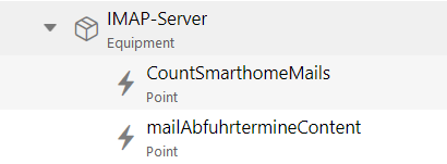

I then linked the two channels to items using the sematic model:

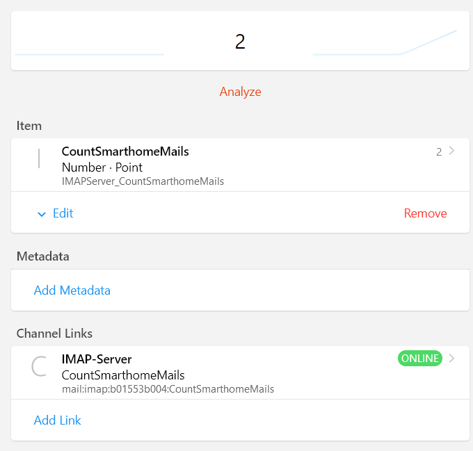

The “count item” gives values as expected:
with the item code:
type: Number
category: ""
groupNames:
  - IMAPServer
tags:
  - Point
But the “content item” is NULL:

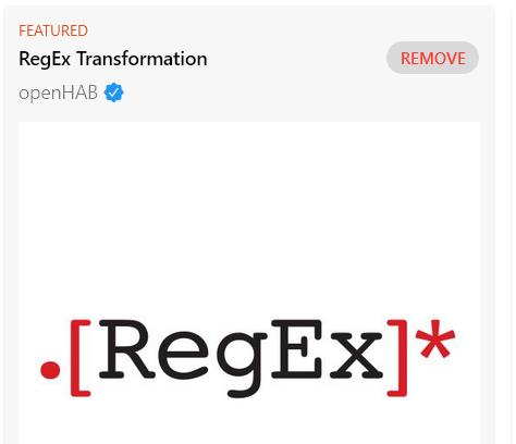

Did you install „regex transformation services“ from the Addon-Store?

Yes, the add-on ist installed:
