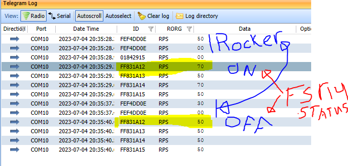

I don,t know how to read the status of a channel from a FSR14 4x Eltaco module.
WIth Dolphine i made a recording:
I push a rocker switch and the FSR14 channels FF831A12 to 15 will send the actual channel status into the system. 0x70 is ON and 0x50 is OFF.
How can i receive this data in a thing and put the status in an item.
Can i use a standard enocean thing and add custum values and status into it?
