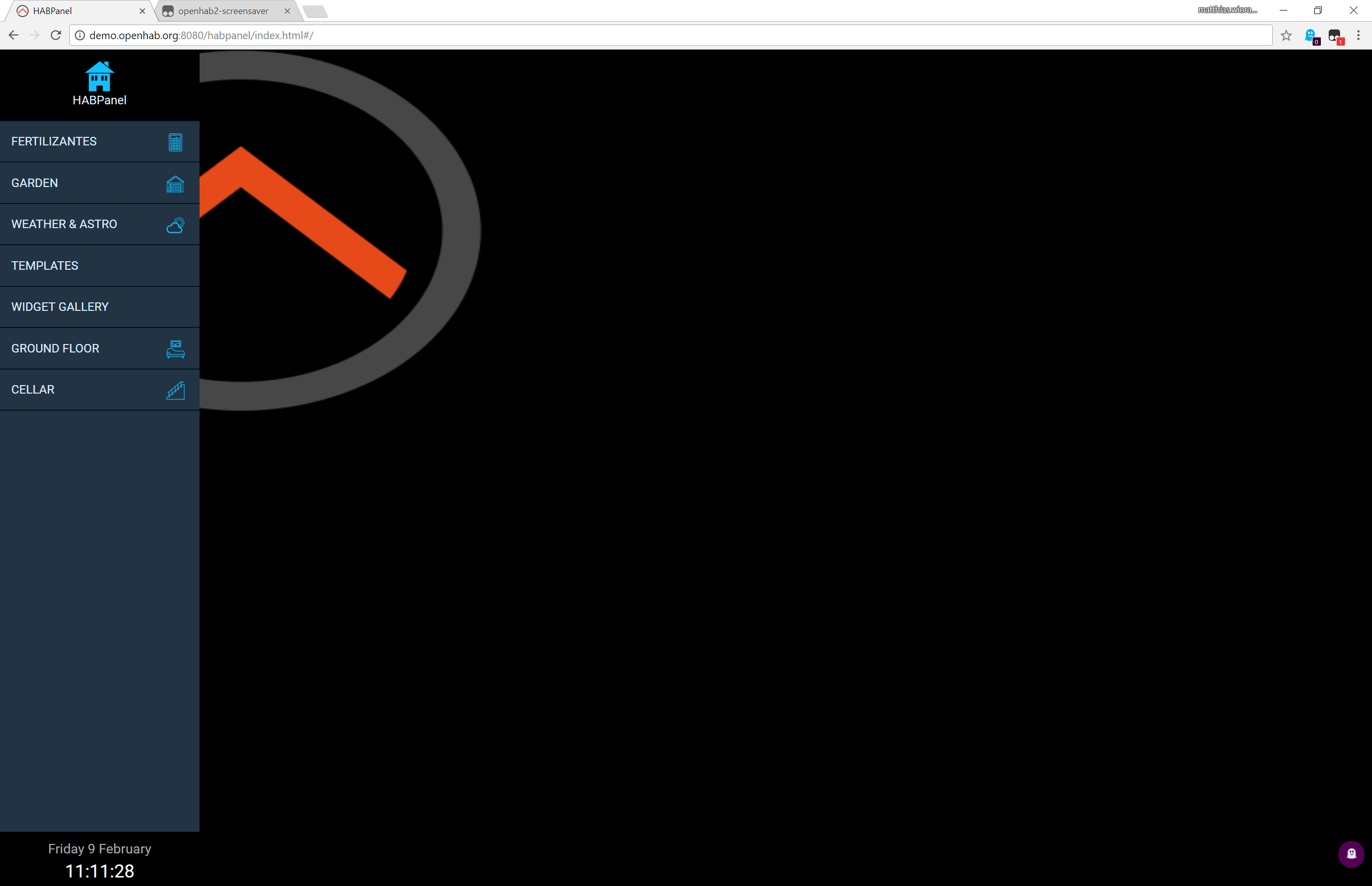

Than I applied the same script-type to the openhab demo (demo.openhab.org : 8080 / habpanel / index.html# /)
which does not work…
here comes the result in a picture, but as a new user I’m not allowed to insert more than 1 image
