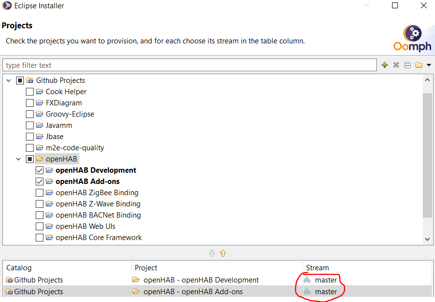

But due to the recent changes related to openHAB version 3.0.0 you need to start of the 2.5.x branch of openhab-addons
Where do I select the 2.5.x branch? When I got to this point in the Eclipse install, the ‘Stream’ only had a ‘master’ choice. Did something go wrong, or is there another place to select 2.5.x?
