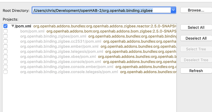

After quite a bit more messing around today, I’m relatively happy that I can get a simple environment working if I only install the OpenHAB Development repo when in the Eclipse Installer. From here I don’t change anything in the POMs, but I import my bindings and mostly it works.
If anything changes with dependencies, bnd doesn’t seem to cope well and it needs a restart of the IDE to resolve it (or at least I’ve not found any other way to recover it as yet!).
Can I suggest that in step 2 above, you change it so as not to say what NOT to do, but instead say what SHOULD be done - it’s clearer this way. I think that for most users, if they only add the development repo, it should work and I think this is what you are saying in step 2, but I’m not 100% sure.
I fear that the more projects that are open, and possibly adding the core development which I have also always done in the past as often this is needed to understand the finer points of what’s happening, will likely lead to more problems. As above, bnd doesn’t seem super stable when resolving dependencies, and any changes in the system quickly seems to get it confused, so keeping a simple setup until this is resolved seems a surer way to success.
So far I’ve only tested out the ZigBee binding, but as that included half a dozen projects, it’s a good test I think. Let’s see if it survives overnight :slight_smile:

Sorry to jump into this again, but…
I’m trying to work out how to resolve dependencies in the ZigBee binding again. I need to change some of the dependency versions, which is simple enough in the POM, and everything resolves just fine in the IDE. However, the demo app doesn’t resolve the new dependency versions - it seems to keep pulling in the ones defines in the reactor.

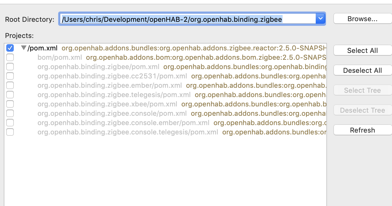

@chris I tried to see if I could reproduce your issue. If I don’t have the root reactor project not in Eclipse then it gives me the behavior you mentioned. When I have the reactor project in Eclipse than it does resolve to version 1.2.6.
Hmm - ok, thanks. I don’t think I have the reactror imported as it had caused other problems in the past. I’ll give this a try though - thanks.
Any idea why this is needed?
@hilbrand Eclipse won’t actually import the reactor -:
I’ve tried this a number of times. I assume when you said “the root reactor project in eclipse” you meant that the project was imported into the workspace - not just that the POM was in the editor? If so, it doesn’t seem that this wants to import.
I tried removing all projects from the workspace and reimporting, but I still don’t end up with a separate project for the reactor. How did you manage to get this to show as a separate project - or do I misunderstand what you did?
Yes I mean the root project that is checked in your screenshot. It shows selected, but you say it doesn’t want to import? What message does it give?
I don’t get any message. In the error log it says the org.openhab.binding.zigbee already exists, but of course that’s not what I’m importing. It also won’t import if I delete all the zigbee projects and select all projects to import…
I’m guessing you’re looking at Top Level Elements Working Sets and that the project is already imported, but not part of the Working Set your’re looking at. See if it changes if you use Projects:
When the project is not in Eclipse and you changed the pom and/or have maven installed it locally, the demo app still could override that file when it resolves. It just downloads the latest version that overrides your own (installed) version. This is unless you have the project in Eclipse. In that case it will take that version. Therefor all files that are changed need to be in a project in Eclipse.
That’s already how I had it configured -:
