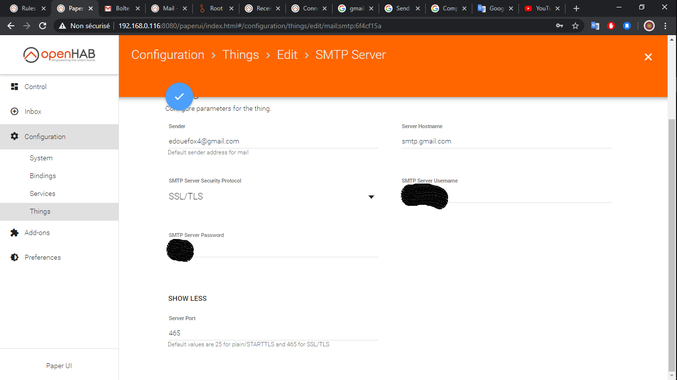

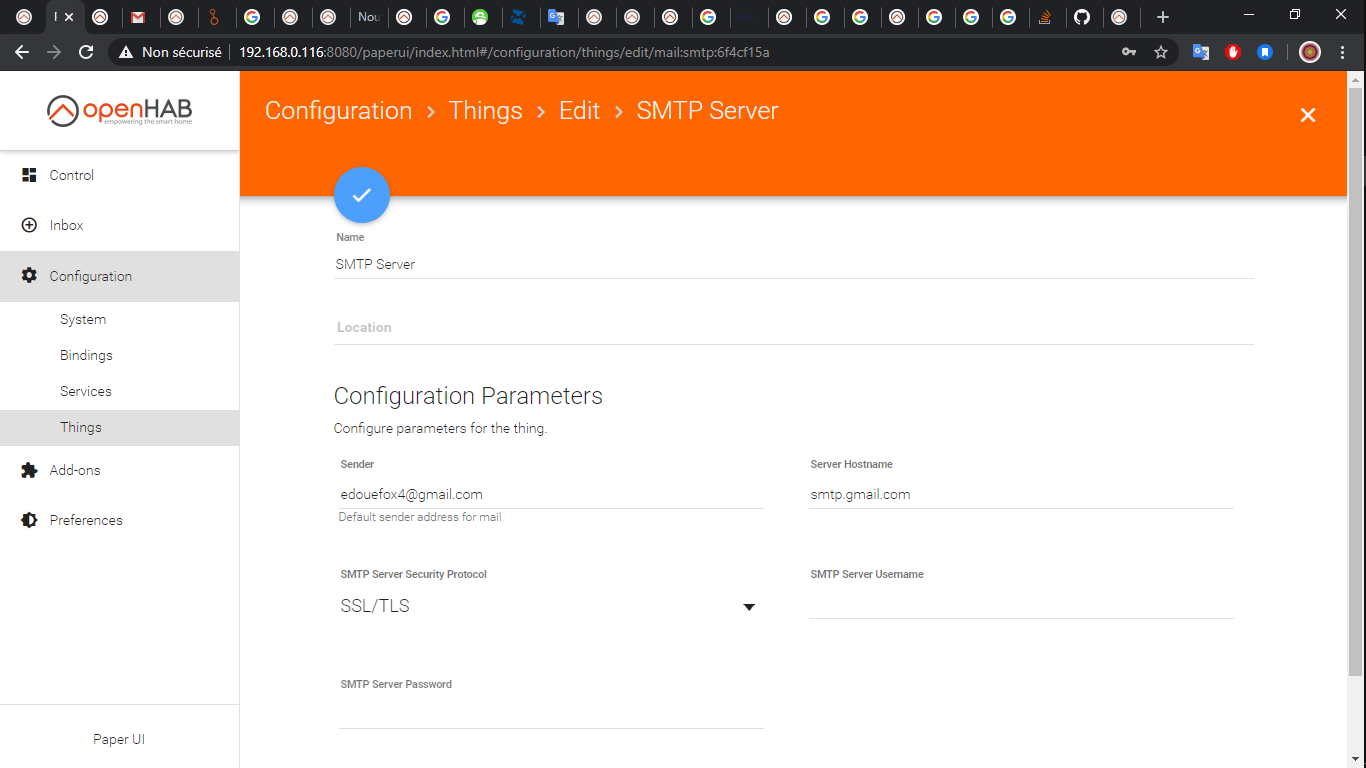

I deleted the mail.cfg file and here is the configuration of the smtp server
but always the same error

I would think you’re going to need at least a username and password to go with that. Don’t show us those in a public forum!
I don’t think SSL is correct for that port

You still have SSL/TLS set, I don’t know if that is correct for that port number.

Leave the “Server Security Protocol” blank, as rossko57 has repeatedly told you to do.
Set the SMTP Server Security Protocol to STARTTLS.
And use port 587.

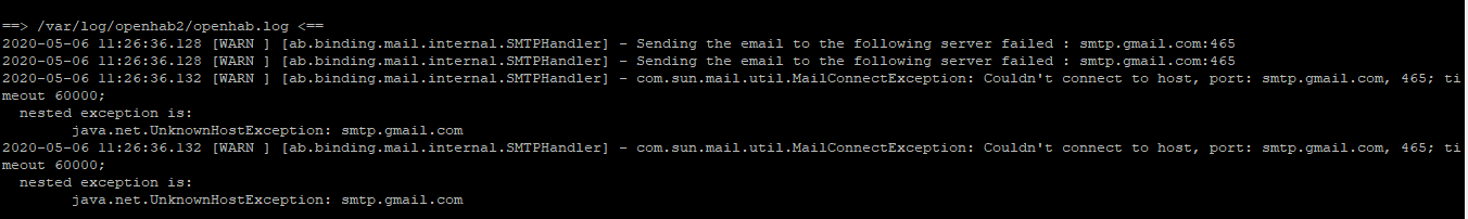

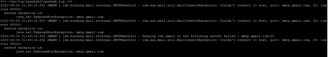

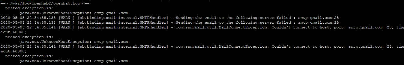

When it fails to connect using your current settings, you should see errors in openhab.log telling you why it failed to connect. For example, when I left the protocol blank it said in the logs that I needed to use STARTTLS. I think the status on the Thing also tells you why it failed to connect also. That will help you understand why it’s failing and what to do to make it work.
