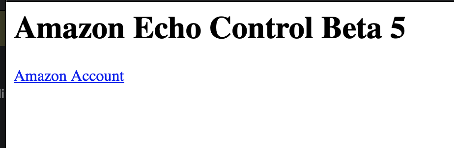

btw, you can check if you have the new version if you open the binding webpage
http://<youropenhab>/amazonechocontrol
You should see the Beta hint on this page:
