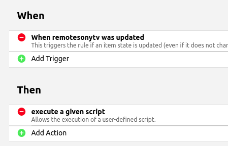

I have a broadlink RM4 clone and I created an item and a rule to control the TV.
I made the rule to use the same name as the actionCommand to be the name of the remote control command.
I also installed this software to run the broadlink to MQTT
EXAMPLE:
To record the command source
mosquitto_pub -h 192.168.0.164 -t broadlink/tv/sony/source -m “record”
to run the command source:
mosquitto_pub -h 192.168.0.164 -t broadlink/tv/sony/source -m “replay”
The source button on the remote has the actionCommand source
Here is the rule:
//need below to log to openhab.log file
//below is if you are going to use the ececute command
var Exec = Java.type("org.openhab.core.model.script.actions.Exec");
//below is also needed for the execute command
var Duration = Java.type("java.time.Duration");
//var HttpUtil = Java.type("org.openhab.core.io.net.http.HttpUtil");
//var HttpGet = Java.type("org.openhab.core.model.script.actions.HTTP");
var TOPIC = "broadlink/tv/sony/"
var stateof = event.itemState.toString() ;
//logger.info("results = " + stateof);
result = Exec.executeCommandLine(Duration.ofSeconds(5), "/usr/bin/mosquitto_pub","\-h","192.168.0.164","\-t","" + TOPIC + stateof,"\-m","replay");
logger.info('The script ran the command '  + TOPIC + stateof);
Here is the widget code:
