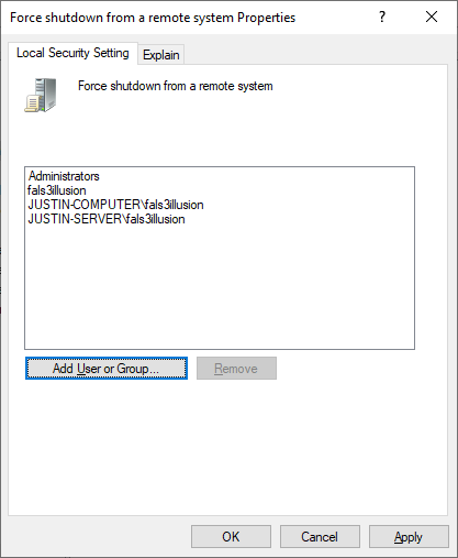

Check that the user that is sending the command is added to the Local Security Policies of the target machine
EDIT: Do not add “Everyone” to this policy or you’re asking for all sorts of trouble :smiley:
Already tried that, doesn’t seem to work. Even for testing purposes i tried “Everyone” and still said access denied. (5)

Username of the remote machine is: PC-Name\username or IP-Address\username
But you also first can try to add the user of the PC were you execute the command, in the policy of PC that should be shut down:
User = PC-Name\username or IP-Address\username

Justin-Server\fals3illusion (Computer that sends the shutdown command)
and also Justin-Computer\fals3illusion (Computer that receives the shutdown command)
and i get an error that says
