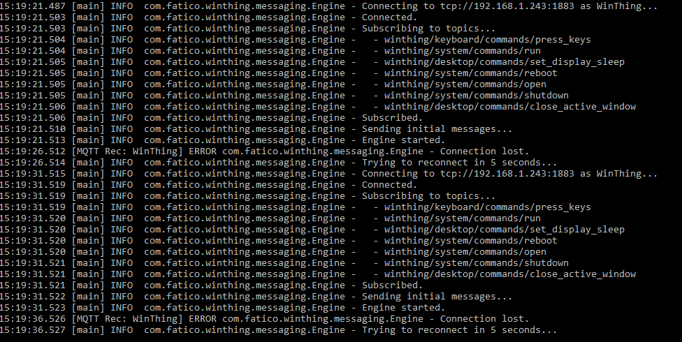

Yes so far so good, I can get the winthings running and see the command prompt.
But when it’s connected it almost immediatly disconnects.
This is what I get from the output from winthings

The problem was that I had 2 connections running with the same id.
