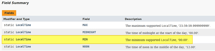

MikeJMajor:
LocalTime
Wow, thank you very much, that’s what I was looking for! I did not find it myself, but you are right, in the docs I find:
That seems to me the best replacement for now.toDateMidnight
