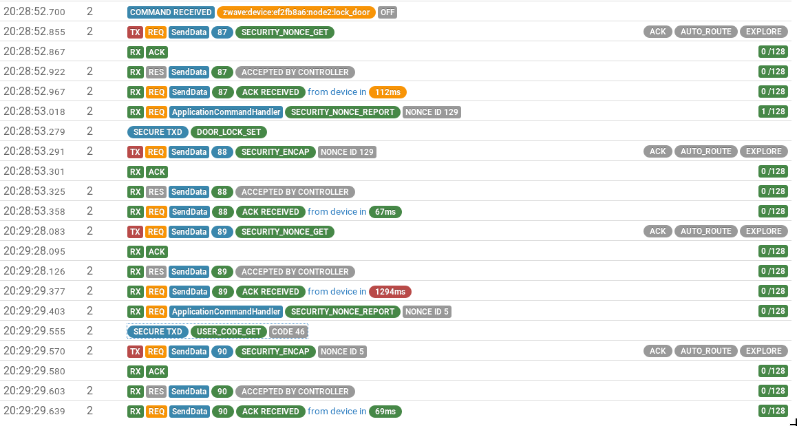

I imported both of them to the log viewer tool on cd-jackson.com, but I couldn’t draw any conclusions based on them. I just saw that there was a lot of activity and something happened almost every minute.

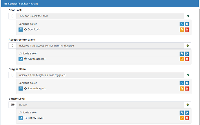

I can see all four channels in Habmin and Paper UI
Can someone make anything out of this?
The log looks like the lock is responding to commands…
But there are some USER_CODE_GETs, so it looks like the lock is not done initializing. Secure devices will take a while, especially locks that have a lot of user code slots. Until it is done initializing, there won’t be a handler assigned to the channels. Try giving it some more time to complete. I’m 90% sure I have this right… Chris will know best!

At one point you had an item linked to this channel. Make sure that you still have one after resetting the lock.

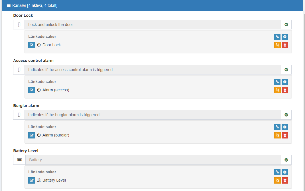

Yes. Based on the image, you had one linked to the channel in this post.
