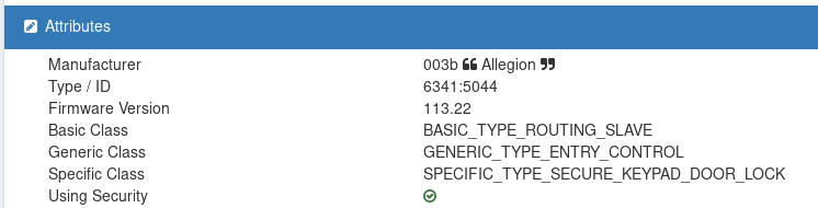

Look under the Thing’s attributes in Habmin. If securely included, there will be a green check mark.
I must have missed your answer Scott. I was able to get the RPi very close to the lock and when I included it in habmin I got the notification in the top right corner that it was securely included. However I thought the security check box was just for informing that the device supports secure inclusion, but this means that it’s been securely included from day 1 :smiley:
