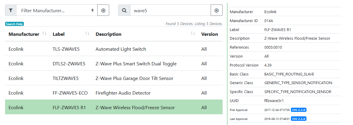

Please check the OpenSmartHouse Z-Wave Device Database for sensors supported by the latest version of the Z-Wave Binding.
As the FLF-ZWAVE5-ECO is not in the DB, you would have to add it to the Z-Wave database:
Yes, that makes sense. If I go for those sensor devices, adding the information doesn’t seem too bad to do, looking over the pages on the database site.
The valve I saw too, similarly doesn’t seem to be in the database.
Edit: I did find this thread ( Aeotec Water Sensor 7 Pro ) that some others have already used the FLF-ZWAVE5-ECO sensor (instead of the Aeotec one) and it was ‘picked up immediately’ .. so I wonder why it wasn’t in that database?
Good find. There is a a FLF-ZWAVE5 R1 flood sensor in the database:
Not sure whether it is the same as the FLF-ZWAVE5-ECO, you should check the manual:
https://opensmarthouse.org/zwavedatabase/744
See tab ‘Reference’.
