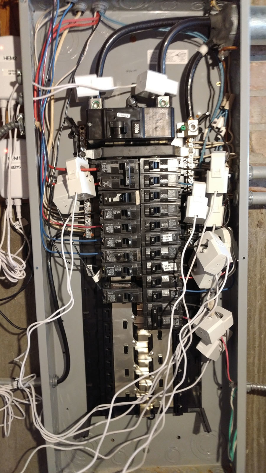

PUTTING IT ALL TOGETHER
To make it all happen, first you need to throw any item that’s a KWH meter into its own group. (Mine is called Group_PowerKWHReport .) Every item also must store persistence data in a queryable database, so mysql is fine, but storing in logfiles is a no-go. I think rrd4j should work as long as you’re not going back in time farther than you’re storing precise data, but I haven’t tried it as I’m a mysql kind of guy.
Finally, you need the following item definitions put somewhere on a sitemap so you can manipulate and see them through the UI:

To use it, adjust the dimmers (ignoring the % signs; can’t find a way to get rid of them) to adjust the start and end days for your report. The date picked will show up in the corresponding string so you know what you’ll be getting. (Might need to manually refresh if you’re on OH 1.8.3 to see it update.) Finally, kick the generate power usage report button to on, and it’ll email out a report like so:
OpenHAB power usage report for 30 days, ending with 2017-01-18T00:00:13.497
Cable modem: 1.571 KWH (11 days) [$0.21]
Bedroom fan: 0.000 KWH (11 days) [$0.00]
Bedroom TV: 3.836 KWH (12 days) [$0.52]
Front bush christmas lights: 2.436 KWH (11 days) [$0.33]
Amplifiers: 1.648 KWH (11 days) [$0.22]
Christmas tree: 1.247 KWH (11 days) [$0.17]
Utility room lights: 0.264 KWH (11 days) [$0.04]
Basement freezer: 16.610 KWH (11 days) [$2.24]
Basement fridge: 4.274 KWH (11 days) [$0.58]
Auxillary HVAC: 3.074 KWH (11 days) [$0.41]
Kitchen oven & dishwasher: 10.998 KWH (11 days) [$1.48]
Kitchen microwave & fridge: 42.116 KWH (11 days) [$5.69]
Bedrooms and attic: 45.569 KWH (11 days) [$6.15]
Washer, dryer & server: 50.818 KWH (11 days) [$6.86]
Primary air conditioning: 2.927 KWH (11 days) [$0.40]
Living & dining rooms: 34.067 KWH [$4.60]
Furnace: 71.181 KWH [$9.61]
House TOTAL: 319.890 KWH (11 days) [$43.19]
End of OpenHAB power report.

I’m using version 1 dual phase Aeon Home Energy Monitors. They’ve been going on sale recently for as low as ten dollars. I originally bought them to use them as $$CHEAP$$ repeaters, but wound up using them as originally intended instead. I have six of them. :smiley:
Here’s a picture of my panel; each white box is a clamp that leads to one of my HEMs. As you can tell, I have one around each phase for my main power, and then a bunch off of branch circuits. They aren’t amazingly accurate (they get decidedly non-linear below about 10W), but I’m not sweating the small stuff; in-the-ballpark numbers are good enough.

I’m going to have to start shopping where you do. I can’t find them right now for less than $25.

Btw, @TheKorn are you in the U.S. ? If so, I wouldn’t post pictures like that one under that thread title :slight_smile:
Don’t worry, I don’t plan on bringing my house’s electrical panel through airport security anytime soon. :stuck_out_tongue_winking_eye:
I guess they’ve gone up in price? I don’t see any for less than $80 on eBay right now.
