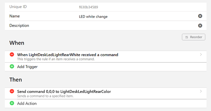

Can confirm, adding this rule to make the white switch when you change its brightness, works perfectly and the LED strip switches over to white, at the brightness you set.
In summary, when you White dimmer is changed, set the ColorPicker to 0,0,0
