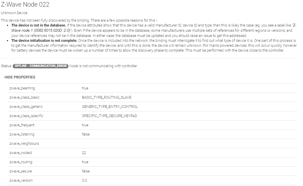

I’ve opened this device and tried to do a secure inclusion from the binding, this is what i get:
If its a case of adding it to your database then ill progress with it.

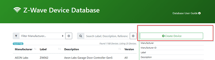

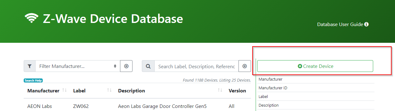

although i dont see a button or anything to add a new device…
Did you follow the guide & submit a ticket to request database access? :wink:
yeah just see that have added a ticket.
