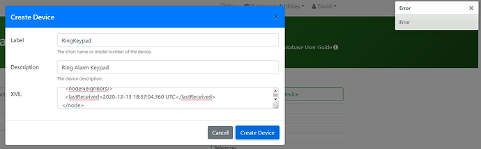

Hi @chris
Trying to upload the xml for the keypad but just get ‘error’.
xml below if someone could add.

It usually adds anyway but I do not see it. I will check further shortly.
EDIT: It did not add for me either. Looking into debug logs…

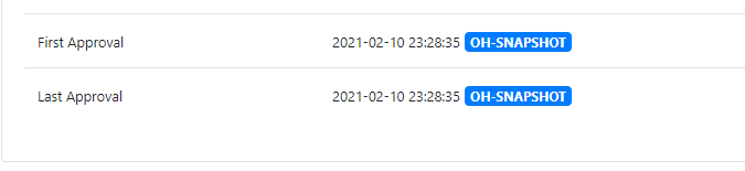

Have you seen that there is in fact an entry in the database?
It is in the database BUT you must be running a 3.1.x Milestone or Snapshot to get it. 3.0.x database is from last December when 3.0.0 was released.
It’s in the database where I started adding it. I haven’t actually had a chance to test it yet though

When I added to the database I might not have set it up properly, it was my first time and ‘just winged it’ with a view to taking a look later.. later hasn’t come yet though :weary_face:
@chris can probably assist or @Bruce_Osborne, I just haven’t got time at the moment, sorry.
I’d need to see the XML file for the device if it’s not being detected. I’m also assuming you’re using OH3.1?
Checking my emails I suspect it is device 1353 in the database.
Yep, that’s correct, there’s a link above, but if this is already in the database I wanted to check the XML from this user as it might be a different set of IDs.
