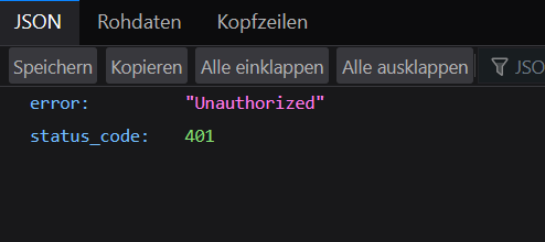

thanks for your response. Is there current another way how to maybe send the video to a recipient? I tried to send the video link through the telegram binding, but this not possible to open the link because of the 2FA authentication …

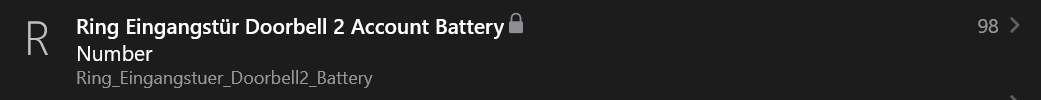

The second problem that I’m forcing is that the battery status doesn’t refresh to the actual state …
OpenHab Screenshot
Ring APP Screenshot
Are there any hints you can give me how to get those things working?
