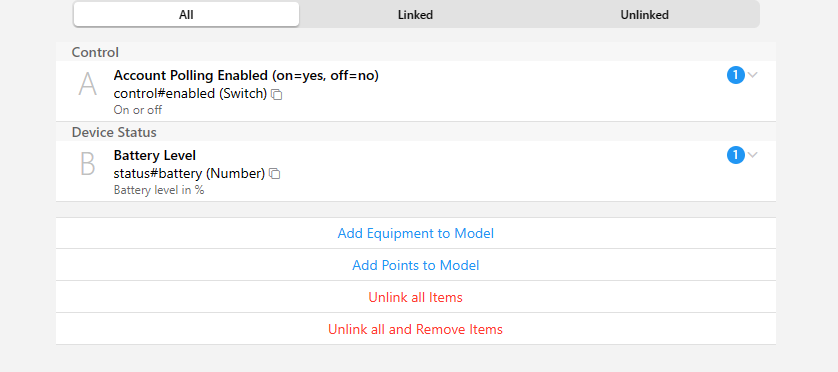

I was able to install the binding and link to my ring account using 2FA. I only see the channels below.
Is this the new jar or the one posted on the main thread? What kind of ring device is it? What OH version are you on?
If its a battery powered camera thats normal. The status channel is actually not implemented and is going to be removed shortly. You should see the event channels under the account thing.

My device is a Video Doorbell 3, secured with MFA.
As stated, file-based configuration is not working, used the GUI way instead and was able to bring the account as well as the device online.
The only channel I see working on the device:
  • Battery Level
The only channel I see working on the account thing:
  • Account Polling Enabled (on=yes, off=no)
  • The description of the Ring device
When the button is pressed on the bell, no other channels are updated, the remain NULL.

That’s expected behavior at this time.
