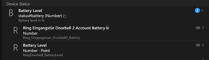

The battery status is working a little bit strange for me at this moment. I figured out if you create a new item for the channel it stays NULL (I tested this behavior with a time of 24h and nothing changed). Only if I disable and activate the thing, the status shows up …
Before reactivate the thing
After…
I set now my Doorbell on the maximum power settings to see if the binding update the battery status if it will get less.

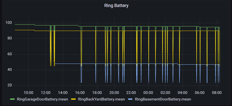

Good news! The battery issue looks fixed. There are several instances on there of the battery going down.
The odd news, all of those spikes to 0. Not sure what’s causing that yet. I’ll attempt to get into the code this weekend or early next week to see what’s happening.
Yup, I can confirm that with an email alert about it. Lol
