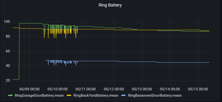

It looks like this may have been on Rings end. My system had several spikes and then went completely calm. Is anyone still seeing the dips to 0?
Everything seems to working now. You are the best :slight_smile:

I’m closing out the battery weirdness as a problem on the Ring side. Mine has been stable for days now.
Awesome! Glad to hear things have sorted out.

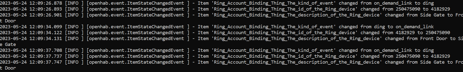

Some slight odd behaviour I’m seeing. I have both a Doorbell and Stick-Up Cam on my Ring Account. Both are detected fine, and both send events. This is all good. I have my Stick-Up Cam setup in Ring as a Linked Event, so that when my Doorbell rings, the Stick-Up Cam also starts recording the event.
However, I’m not sure if this is somehow causing a conflict in the Binding. My Event timestamp updates correctly, but after the Event changes to ā€œdingā€ from the Doorbell being rung, every several seconds the Event alternates from ā€œdingā€ to ā€œon_demand_linkā€ and back again - without the Event timestamp changing. It looks like the OpenHAB Item for the Event is alternating between the two without a new Event timestamp?
Here’s a screenshot of my Logs:
Can you please put the binding into trace (this will get verbose), trigger an event, and send me the whole thing in a text file via DM? I’ll need to see what they are sending us before I’ll be able to see why that’s happening.

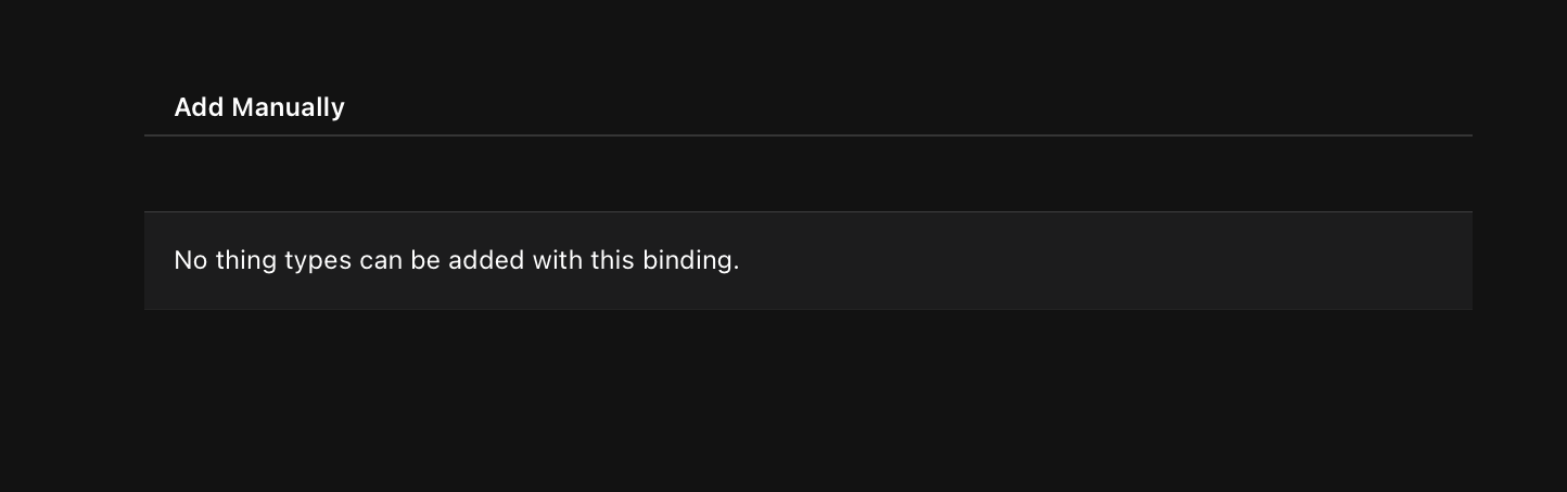

Do I miss something?? I just added the ring-binding from the market-place and tried to add my account, but there ist no possibility to add the account-thing. The docu said ā€œuse the paper-UIā€, but I use OH4, and do not have the paper-UI…
If I use the textual-config (which is not recommended if one use 2FA, what I do), I get the account-thing, but cannot edit it to use 2FA, because its locked.
any hint would be great!
Good point with the paper UI. On OH4 that would just be the main UI. When you go into things on the main UI, hit the plus, and hit Ring it’s just blank? What OH4 version are you on? I’m running a snapshot that’s maybe a week old and it’s been ok.

That’s odd. Ill try to grab some screen shots later today on my dev box to compare against. You should see an option to manually add the account thing. Have you restarted openhab? Maybe clear cache?
Thanks. I have restarted openHAB and stopped, cleared the cache, and restarted. I was using the .jar file provided above in openHAB 3.4.4. When I upgraded to openHAB 4.0 SNAPSHOT, I deleted that .jar file from the addons folder and then installed the Ring binding from the Marketplace. Anything I can do to help troubleshoot, please let me know.
Just to make sure I’m understanding, it worked on 3.4.4 but fails on 4.0?
I filed a bug on this. For some reason, marketplace added bindings aren’t showing manual things to add.
It’s more than just 3.4.4 to 4.0. 3.4.4 is running on a Pi4B that has been upgraded from earlier versions. There are many openhab2 folders and files remaining on it, such as the one I’m getting an error for not being available for the binding to write to. 4.0 is on a clean openhabian install that doesn’t have any of the legacy remnants. I backed up openHAB on 3.4.4 and restored it on 4.0. Maybe there is something in those files that points to the old openhab2 structure. Or maybe the code was written originally for openhab2 and most systems have the legacy folder available.
Try to download the jar and put it in the addons folder instead of installing from the marketplace.

Used the jar from the first post now and get the account-thing running now. Also my (3) wired doorbells are discovered via a manual scan now and are working (2 Channels: Battery-Level and Account-Polling).

Glad to hear it’s working. Hopefully that bug will be fixed soon and the marketplace will work again.
