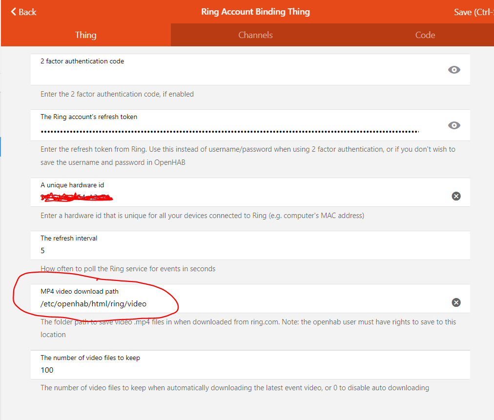

The path where video’s download can be changed to anything you want. That path was just the original path when it was developed.
Go into the Ring Thing Account and click advance. See the path area:
Best, Jay
Changed it to /etc/openhab/html/ring/video from /etc/openhab2/html/ring/video, and now it works.
I’m not sure how what was there go there in the first place. Perhaps I played around with an early version and it stuck. Regardless, thanks for the tip.
I’d have to go dig out the code, but I believe it pulls it from one of the OH variables. Also once it sets then it holds in the thing config.
