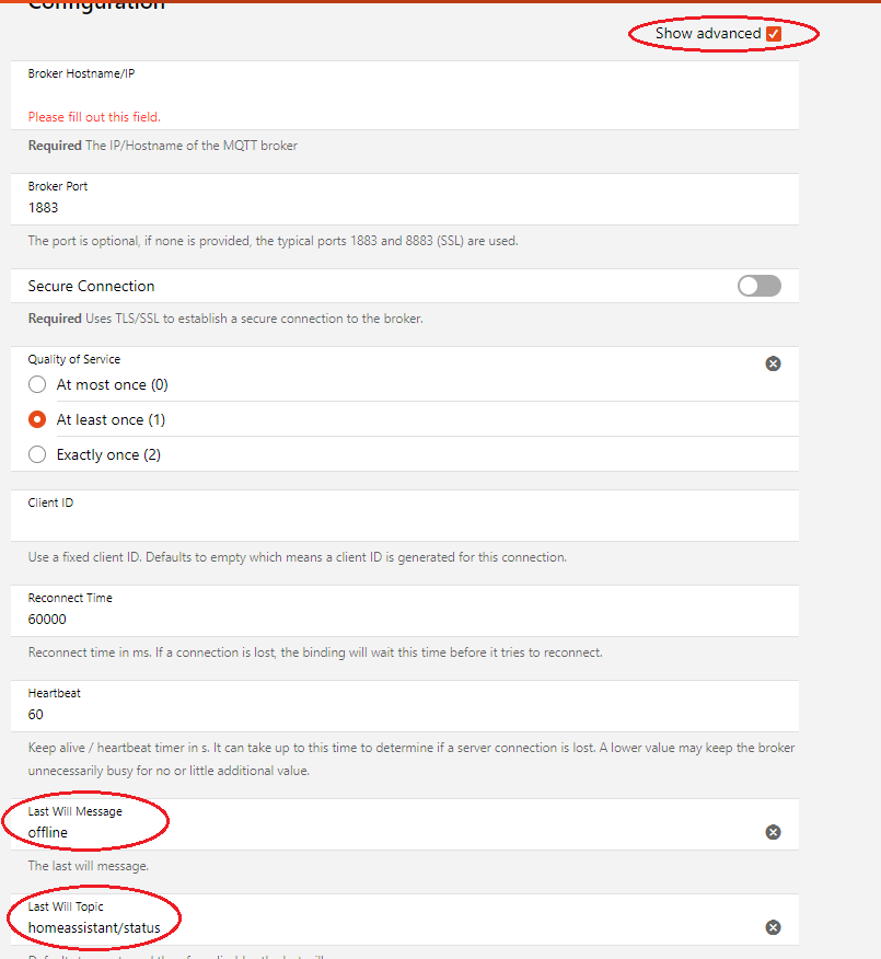

According to the GitHub issue you linked, all we need to do is publish offline and online messages to the homeassistant/status topic to have it re send the config messages so that’s all we should need to do if I understand properly
edit:
Here’s the rule I put together that does just that. Running it manually forces ring-mqtt to re-send all the config topics as well

Also, while the ring-mqtt doesn’t appear to listen for “offline” on the homeassistant/status topic, I configured my mqtt broker to send it anyway out of caution

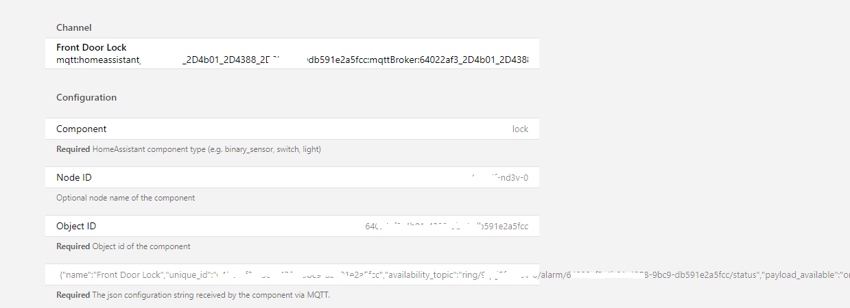

The channel itself is auto configured like this:
The full text that runs off the side for the bottom is this (UIDs partially redacted)
{"name":"Front Door Lock","unique_id":"xxxxxxxx-db591e2a5fcc","availability_topic":"ring/xxxxx/alarm/xxxxx-9bc9-db591e2a5fcc/status","payload_available":"online","payload_not_available":"offline","state_topic":"ring/xxxxx/alarm/xxxxxb591e2a5fcc/lock/state","command_topic":"ring/xxxxx/alarm/xxxxx9-db591e2a5fcc/lock/command","device":{"ids":["xxxxxc9-db591e2a5fcc"],"name":"Front Door Lock","mf":"Kwikset","mdl":"Lock"}}
