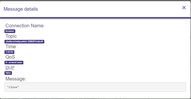

what is the message payload that the endpoint is publishing to the status topic? (check with your mqttLens)
i dont know which information do you need.
Is it enough?
since the endpoint is not reporting a percent status, you won’t be able to get the proper status in OH2 (using a Rollershutter Item)
It seems that the 3 possible status messages that it reports are: OPEN, CLOSE, STOP
