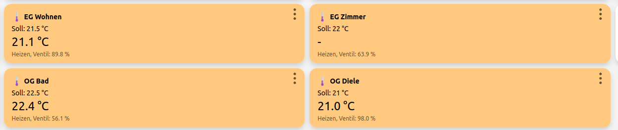

As you can see the OG Büro value has too many digits.

On some widget instantiations the value is not displayed:
The value of “OG Bad” is undefined.
