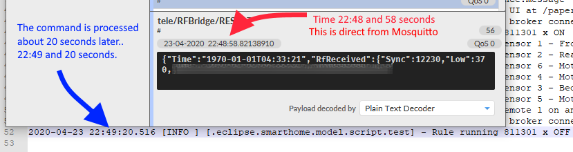

To show this occurring, below is a capture direct from Mosqitto where you can see that the MQTT command arrives at 22:58 and 58 seconds, but Openhab’s logs, shows that the On/Off command that the rule doesnt run until 22:49 and 20 seconds (22 seconds later).
Obviously, because I have to wait 5-8 hours for this issue to occur, its hard for me to get diagnostic data together, but I managed to do another test today, as follows… Can I turn the light on/off in the Openhab interface, while Im waiting for this rule to be processed? e.g. is Mosquitto, MQTT or Openhab (other than rule processing) an issue?
So I opened the Openehab Android app on my phone, and pressed my RF button… The lights didnt turn On at this point. I then turned the lights on in the Openhab Android app, and they came on… then I turned them off again… all of this within the 20 seconds time. After another 10 seconds or so, the lights turned on, which would be the rule being processed.

This one shows a 13 second delay. The 3rd line is me pressing the button.
On the line that says “RFDataLights changed from 3D1301 to NULLFORTESTING” I put this into my rules to reset the RFdataLights variable so that the event log would always show a change event when I pressed a button.
Ill keep on with the Java settings, but hope this provides the event.log detail you wanted.
