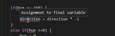

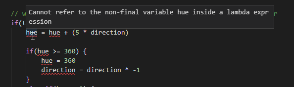

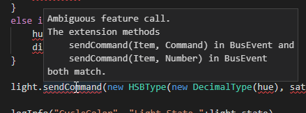

Hi @rlkoshak,
opening your code to an editor i got some alert on variable and command inside timer:
In the log I got this exception when timer is reached:

For the hue problem, honestly, we don’t really need that variable. I only continued to use it be a little closer to the old code. But the error is a little odd because I’ve done this before. I think that VSCode is marking that as an error incorrectly. Let’s ignore it for now.
The second error (“Ambiguous feature call”) is referenced in the comment I added to that line. That used to be a problem but I thought it no longer is. It was fixed in the original code using toString on the new HSBType in the sendCommand.
The third error is because direction is defined as a val instead of a var and we are trying to change a val. It should be a var. Of course, once we do that we will get the same error we got with the hue variable.
