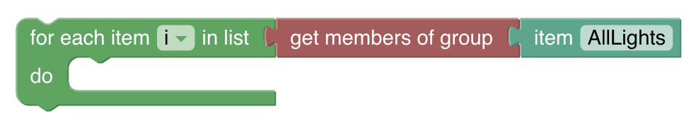

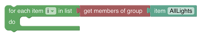

Assuming they are all in a Group called AllLights:
That should only be used as a last resort in all circumstances.
