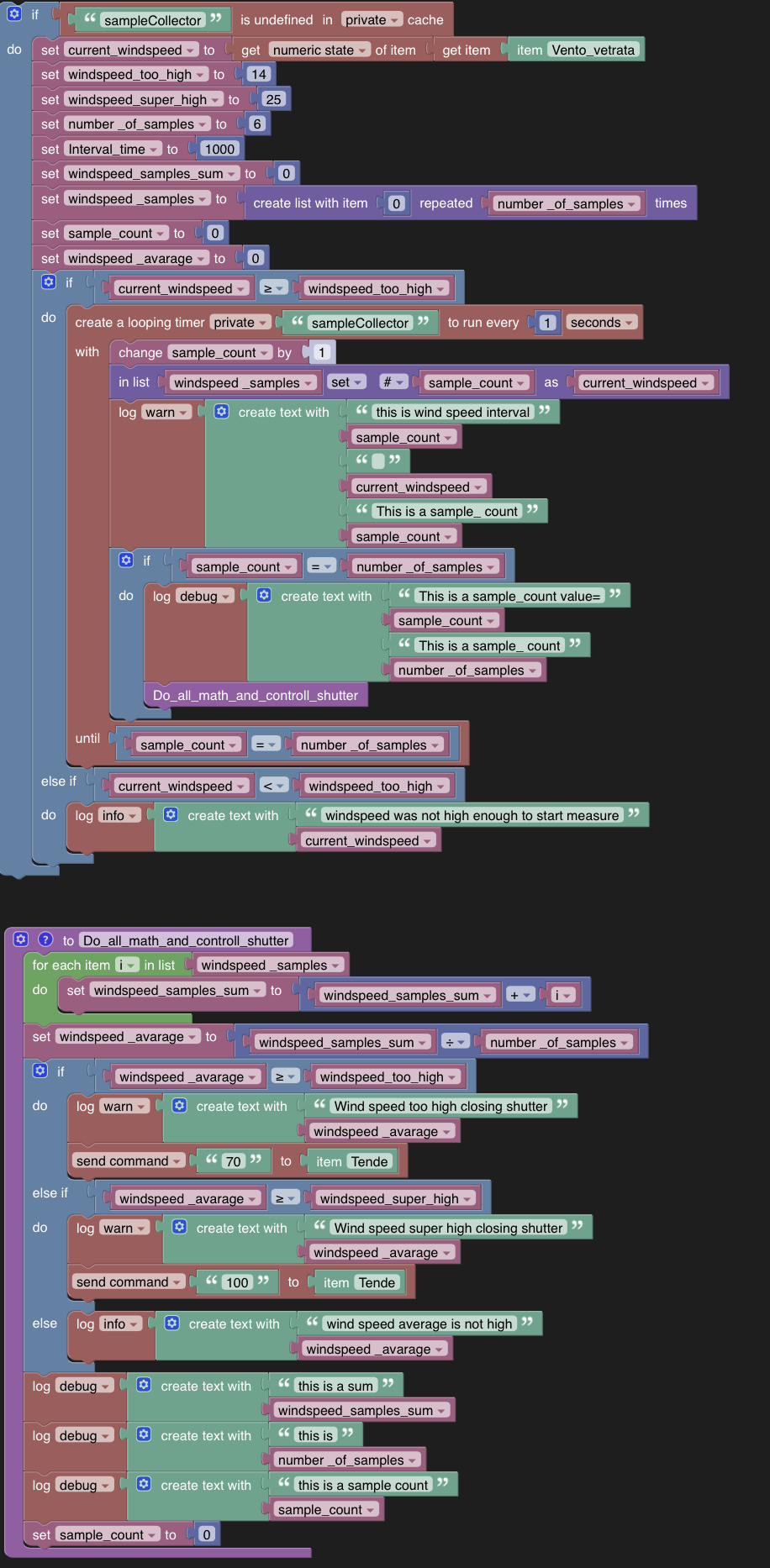

This is the line that’s the problem.
var future_predictor = setInterval(MySampleCollector, interval_time);
That line runs every time the script runs and every time it runs, it creates a new Interval.
That section of the code will indeed clear the interval once that specific timer reaches ten samples. But future_predictor won’t be pointing at that timer any more, it’ll point at the interval created in the most recent run of the rule. Every time the rule triggers, the rule also resets the sample_count and future_predictor.
Let’s imagine we trigger the rule three times within ten seconds.
  1. interval1 is created, sample _count is 0
  2. one second passes
  3. interval1 runs, sample_count is set to 1
  4. half a second passes, rule is triggered again
  5. sample_count is set back to 0, interval2 is created, reference to interval1 is lost
  6. half a second passes
  7. interval1 runs, sample_count is set to 1
  8. half a second passes, interval2 runs, sample_count is set to 2
  9. a quarter of a second passes, rule is triggered again
  10. sample_count is set back to 0, interval3 is created, reference to interval2 is now lost too
Hopefully you can see now how the intervals continue to build up. The rule doesn’t check before creating a new one so every time the rule runs it resets all the variables and creates a new interval without clearing the old one so the old one continues to run.
Now ten seconds have passed and we finally get to that block of code at the end of “do the math…”.
  1. interval1 reaches sample_count == number_of_samples_to_take
  2. clearInterval(interval3) gets called because future_predictor only points to the most recent interval created
  3. interval2 reaches sample count == number_of_samples_to_take
  4. clearInterval(interval3) gets called again
Interval3 got cancelled so it never runs again. But because interval1 and interval2 never got cleared, they continue to run every second forever or until they error out (the way it’s written it will never error out so the intervals continue forever).
In addition to increasing the likelihood of multithreaded exceptions, you can also expect that the time between samples gets shorter and shorter too as the separate intervals run at less than a second apart.
What I’m saying is you shouldn’t blindly create a new interval if one is already running. If you do need to create a new interval, clear the old one first.

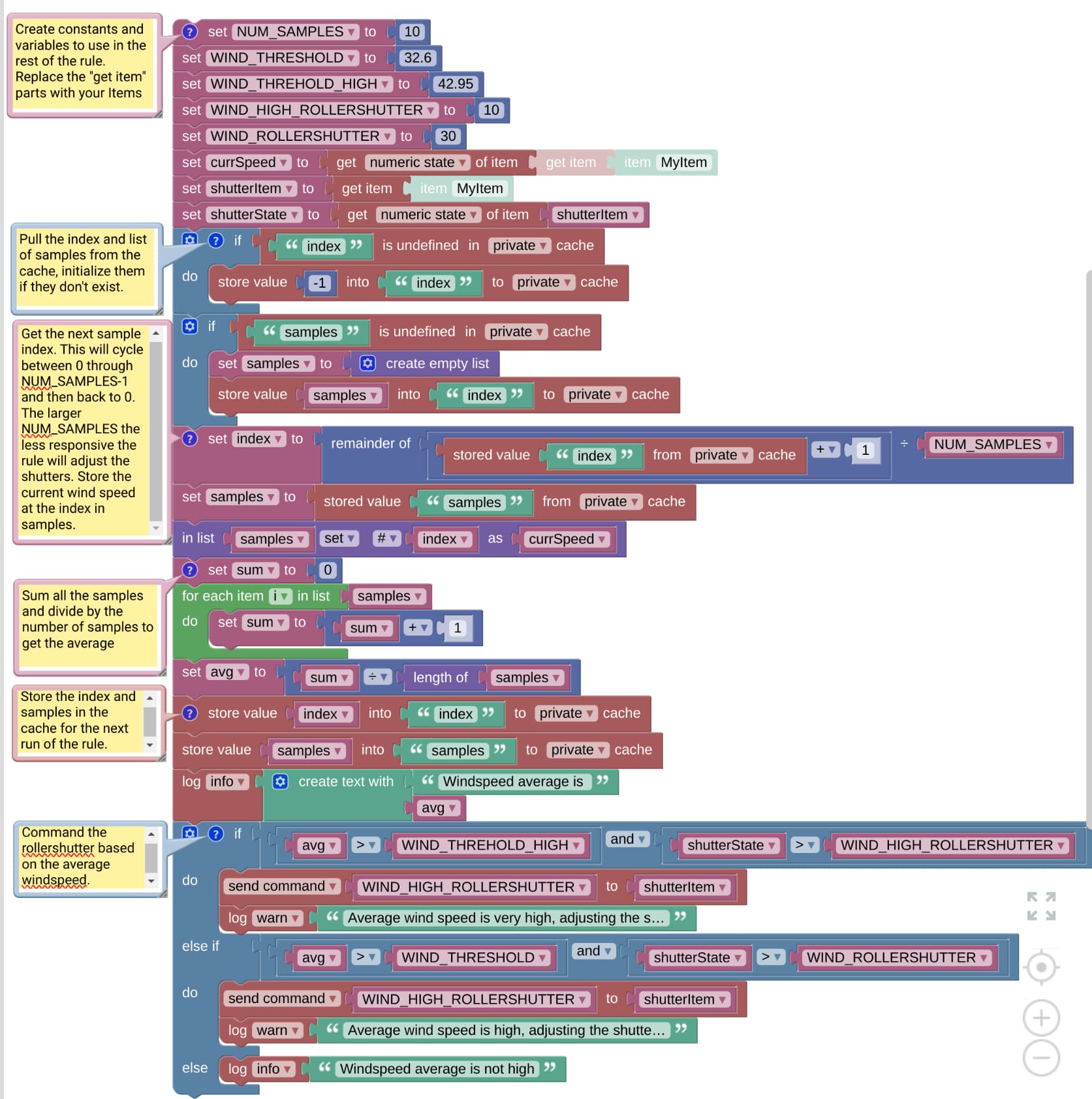

The cache is mainly being used here because that’s the only way that the reference to the previously created interval on the previous run of the rule can be seen. Without using the cache, the reference gets lost and the second trigger of the rule can’t know that an interval is already running. The cache is how data can be persisted across multiple runs of the rule.
No, intervals and timers don’t consume a thread except when they are actively running so you’d never see more than one thread in use in any given thread dump. If two threads were to try to run at the same time the multithreaded access exception will be thrown.

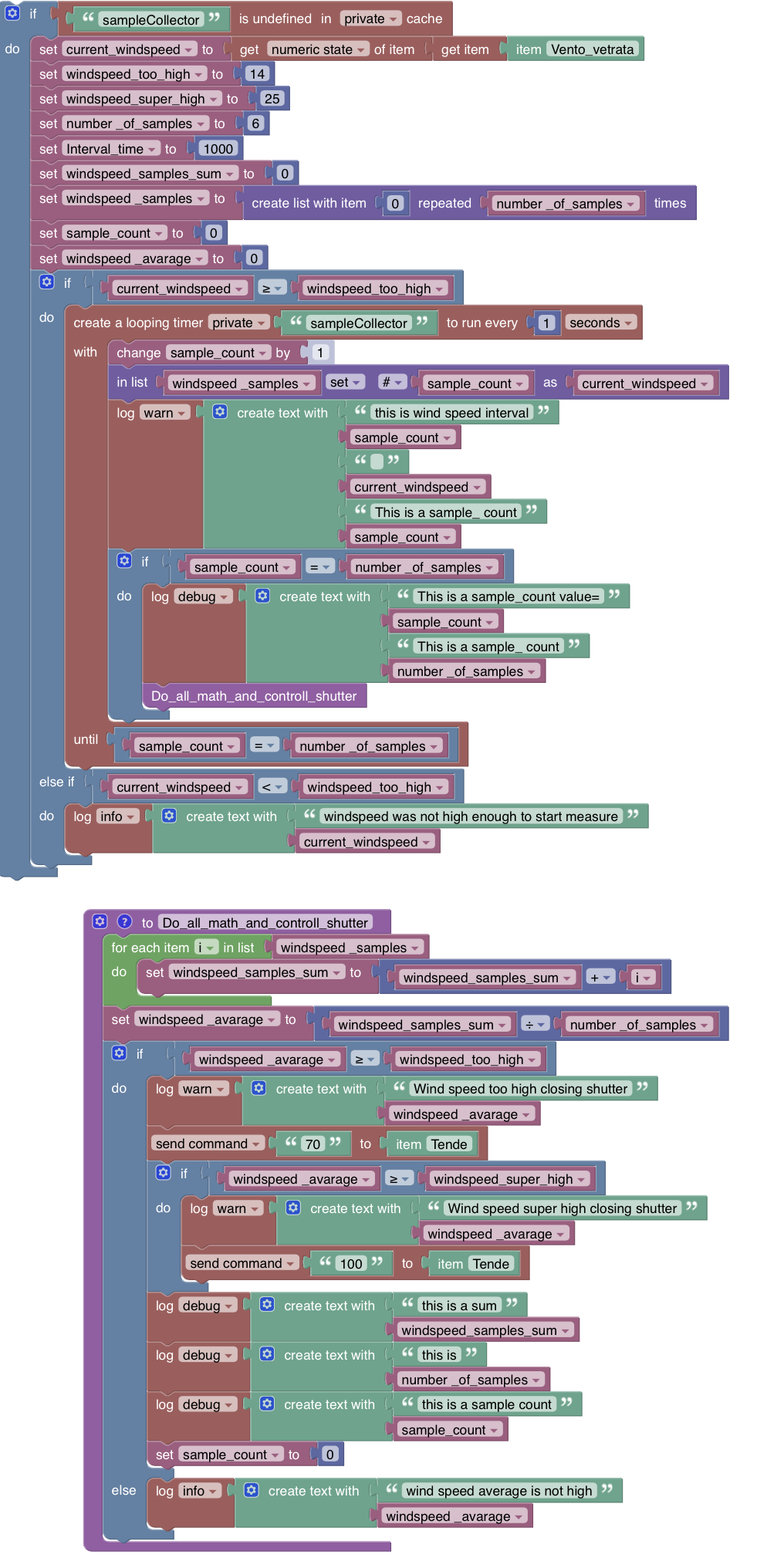

Hi Rich,
I follow your points and understand how if the rule was retriggered during the sample interval that could happen and it would orphan the previous interval timer.
However if the rule was not retriggered during the 10 seconds the samples where being collected then it would run to completion clear the interval timer and on next trigger reset and start all over correct?
This was exactly why I asked OP to create a generic switch item to be turned on when rule started and then asked him to set his “But only if” conditions to only allow the rule to trigger when the switch was off. The “windspeed_monitor_cycle_active” variable was just a way for him to expand or add some bell , whistle other action to take only when it was running it was purely optional (actually a remnant of something else I use a similar rule for. And just left it in the code in case it was needed. Since this approach would not have blocked a rule trigger without as you say setting it in the cache and having the rule read its state). I saw that getting very complicated to try and explain to the OP so I avoided that approach. The main reason I did not do a list or even create an array or add a for loop was I wanted to keep the flow and script behavior as clear as possible since when someone is unfamiliar with scripting it is easier to explain a conditional if statement’s behavior and much easier for them to follow that flow. I also agree it had no error handling again same reasoning easy to explain. And yes I also agree recommending him to use Blockly would be better and make it easier for other folks to help him going forward.
what I had expected he would have ended up with was something like this

And I would not have thought this would create the error he mentioned.
So this is where I am still a bit unclear and why I was asking for his occurrences.
So based on this complete sample I posted above do you think this also would have caused the error or abandoned timers?
Correct, if you guarantee that the rule does not run in the ten seconds that the interval is running then there shouldn’t be a problem. But you repeatedly triggered the rule manually much faster than ten seconds and saw the multithreaded exception and I was explaining why and how to avoid that.
This is not a complete solution because of timing. It is possible for the rule to trigger and start running between the time the “locking” switch has the postUpdate to ON called and the Item actually updates to ON.
The problem with that variable, as implemented, was the same as future_predictor, it gets reset every time the rule runs.
It largely depends on how often the wind sensor reports. If it reports often (every second or less) the likelihood that the timing works out just wrong increases.
It would happen less often by a lot but it wouldn’t eliminate them. The timing could work out just right between updating the condition Item and the Item actually changing state that a second run of the rule would proceed when it’s not supposed to. A Switch Item makes a really poor lock.

cache.private.get('i', () => -1 Pull the last index i from the cache. If it doesn’t exist, initialize it in the cache as -1 and return that.
var currSampleIndex = (cache.private.get('i', () => -1) + 1) % NUM_SAMPLES; Once the last index is pulled from the cache, add one and then do a modulo (aka remainder) with NUM_SAMPLES. So when the value gets to 10 it will return 0 and start the index over again. This creates a circular index which goes from 0 to 9 and back to 0.
var samples = cache.private.get('samples', () => []); Pull the list of samples from the cache. If it doesn’t exist initialize the cache with an empty list and return that.
samples[currSampleIndex] = items.Windspeed.numericState; Store the current windspeed in the list. In JavaScript you do not need to preallocate the array so the array will grow as needed.
var sum = samples.reduce( (result, a) => result + a, 0); JS Arrays (other languages too) support powerful operations that can manipulate the values of an array. I’m using reduce here to sum up all the members of the array. See JavaScript Array reduce() Method
Everything else is straight forward basic JavaScript.
The above is very implementable using Blockly as well.

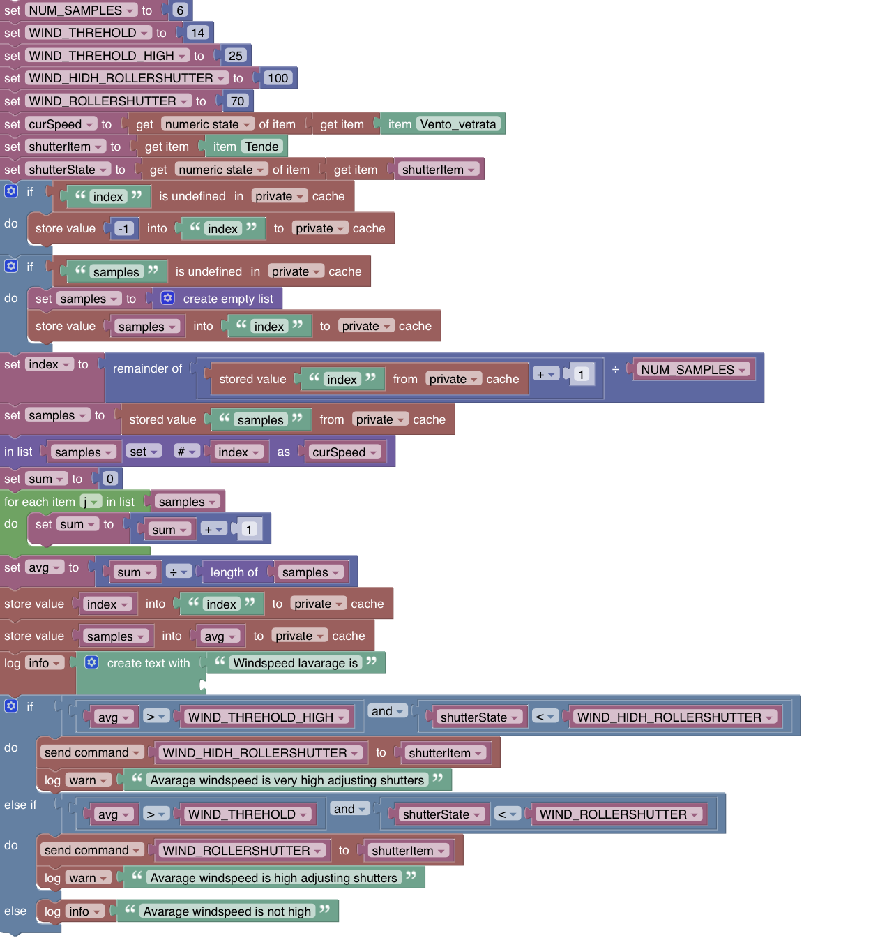

Hi tried to follow your discussion, got lost obviously. My initial intention was to extend my old rule to roll the shutter up and building step by step a rule to move dynamically my shutter based on calculate virtual outside solar light and wind condition, to roll them up partially or totally on windspeed average and even to roll them back if the wind get low during the day. Is it for your experience possible that?

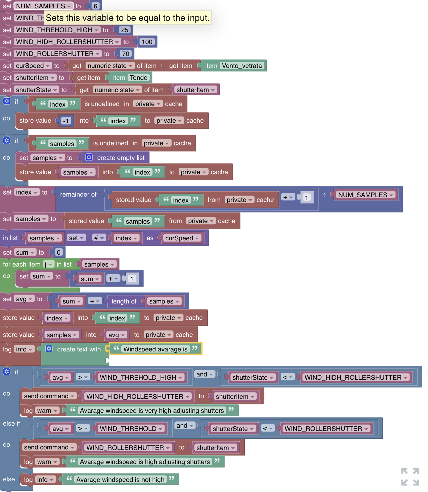

Tried to copy with blocky Rich’s rule adding a second command for “windspeed super high” and found this warn in the logs
Is it that because I added a “wind:super_high” trigger command?
Don’t know if it helps somehow.
My shutter never received command “100” only “70” also if the average was higher then super_high_windspeed trigger. Do I put the command in a wrong way?
Thank you both of for your time and to Rich who gave me an example building rule with Blocky.

I have changed the rule in this
the problem is that once triggered the rule doesn’t stop the cycle even if the sensor is inactive and my shutter recive command 70 and 100 repeatedly. This is the logs

How often does the wind Item update?
Post the code generated by the blocks.
I agree it’s not because of the two commands. I’m not sure what it causing it though. Despite all that has been posted here, there isn’t enough information to diagnose the source of the problem.
I might have made an assumption somewhere that doesn’t hold true. Seeing the code generated by the blocks will help.
However, I think it might be prudent to move to the cron based approach like I posted above, at least for the short run. It eliminates all the complexities that come with managing a timer and it provides a running average as opposed to a ten second average every ten seconds. This should make it much easier to debug. This also eliminates any possibility of the multithreaded exception because there are never any timers running in the background. And by eliminating the timer, the whole logic becomes more straight forward overall. This version should be easier to debug and expand/adjust going forward.
As I wrote above, use a time based trigger using the cron expression above to run every second. Then the Blockly version of the code will look something like this:
Be sure to set the MyItem blocks to your Items. You can adjust the thresholds and number of samples to tune the behavior. For example, a smaller NUM_SAMPLES will make the rule more responsive since it will be averaging fewer readings, but it will also be more variable.
The rule will run once a second, record a sample and throw away the oldest sample, and calculate the average of the samples. So if NUM_SAMPLES is 10, it will calculate a ten second running average every second. Then it adjusts the rollershutters based on that running average.

I think I see the error.
On the line that sets “shutterState”, it should read “set shutterState to get numeric state of item shutterItem”, not “set shutterState to get numeric state of item get item shutterItem”
Post the code that is generated by the blockly. It’s impossible to tell which block is throwing that error, but with the code I can find the line number reported in the exception (line 11).
As @rlkoshak has asked you already please post the code behind your blocky.
Once you have eliminated this latest new error
Keep in mind regardless of the approach you go with timers or continuous run cron expression The rule with keep sending the commands to take action to the shutter repeatedly.
The reason is you do not have a condition check to block the sending of the command if the shutter value is already completed.
The if check for wind speed also needs an additional check to confirm the shutter is not already in the state the command would tell it to go to. Otherwise, it will spam your event bus because the wind speed check is greater than the threshold resolves to a true condition until the wind speed drops below the exceed value.
Edit: Never Mind I saw in your latest post and version you added that check .
Even though the latest versions of the code do have the checks in place, I just want to mention that repeatedly commanding the Item even when it’s not needed is not necessarily a problem, so long as the developer is aware that will happen.
I will defer offering an opinion on that statement and refrain from further engaging in what if discussions.
I don’t understand this statement at all.
Your reply does strongly imply an opinion and my statement isn’t a what if discussion. Given how OH works, the bindings, and the underlying technologies, sending a command to an Item that doesn’t need it does not always cause problem. In fact it rarely causes a problem. You can test that your yourself, anyone can. It’s super easy to test.
Even though it came as a reply to you, my statement wasn’t really even directed at you. It was directed at @Jadblack and future readers of the tread. Essentially I’m saying “hey man, don’t worry about the extra commands, they aren’t hurting anything, let’s focus on what’s not working”.
But if you want to not talk about it by announcing how you’re not going to talk about it, that’s fine too. You seem to be taking issue with something I’ve said so maybe I should just bow out. I can’t imagine how I may have caused offense but if I have, I apologize.

Hello, I have corrected the rule as suggested by Rich and this is the code generated

        var NUM_SAMPLES, WIND_THREHOLD, WIND_THREHOLD_HIGH,
        WIND_HIDH_ROLLERSHUTTER, WIND_ROLLERSHUTTER, curSpeed, shutterItem,
        shutterState, samples, index, sum, j, avg;
        NUM_SAMPLES = 6;
        WIND_THREHOLD = 14;
        WIND_THREHOLD_HIGH = 25;
        WIND_HIDH_ROLLERSHUTTER = 100;
        WIND_ROLLERSHUTTER = 70;
        curSpeed = items.getItem('Vento_vetrata').numericState;
        shutterItem = items.getItem('Tende');
        shutterState = shutterItem.numericState;
        if (cache.private.exists('index') === false) {
          cache.private.put('index', (-1));
        if (cache.private.exists('samples') === false) {
          samples = [];
          cache.private.put('index', samples);
        index = ((cache.private.get('index')) + 1) % NUM_SAMPLES;
        samples = (cache.private.get('samples'));
        samples[(index - 1)] = curSpeed;
        sum = 0;
        for (var j_index in samples) {
          j = samples[j_index];
          sum = sum + 1;
        avg = sum / samples.length;
        cache.private.put('index', index);
        cache.private.put(avg, samples);
        console.info(('Windspeed lavarage is' + ''));
        if (avg > WIND_THREHOLD_HIGH && shutterState < WIND_HIDH_ROLLERSHUTTER) {
          shutterItem.sendCommand(WIND_HIDH_ROLLERSHUTTER);
          console.warn('Avarage windspeed is very high adjusting shutters');
        } else if (avg > WIND_THREHOLD && shutterState < WIND_ROLLERSHUTTER) {
          shutterItem.sendCommand(WIND_ROLLERSHUTTER);
          console.warn('Avarage windspeed is high adjusting shutters');
        } else {
          console.info('Avarage windspeed is not high');
    type: script.ScriptAction
When the item wind changes I found thes on the logs
2024-05-05 10:36:30.279 [ERROR] [b.automation.script.javascript.stack] - Failed to execute script:
org.graalvm.polyglot.PolyglotException: TypeError: Cannot set property "0" of null
	at <js>.:program(<eval>:21) ~[?:?]
	at org.graalvm.polyglot.Context.eval(Context.java:399) ~[?:?]
	at com.oracle.truffle.js.scriptengine.GraalJSScriptEngine.eval(GraalJSScriptEngine.java:458) ~[?:?]
	at com.oracle.truffle.js.scriptengine.GraalJSScriptEngine.eval(GraalJSScriptEngine.java:426) ~[?:?]
	at javax.script.AbstractScriptEngine.eval(AbstractScriptEngine.java:262) ~[java.scripting:?]
	at org.openhab.automation.jsscripting.internal.scriptengine.DelegatingScriptEngineWithInvocableAndAutocloseable.eval(DelegatingScriptEngineWithInvocableAndAutocloseable.java:53) ~[?:?]
