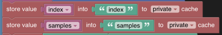

There’s another typo.
The block that reads “store value samples into index to private cache” needs to read “store value samples into samples to private cache”.
But I want to make sure you understand why this was the problem. You need to understand this code to be able to maintain and expand it in the long run and you need to know how to debug problems like these because you’re not going to always have @justaoldman and me too do this for you.
We’ve provided examples and are happy to help get those working, but if you don’t understand enough to do a little debugging on your own, eventually this code will break and you won’t be able to fix it, you won’t be able to expand it in the future, and you won’t be able to write your own rules from scratch.

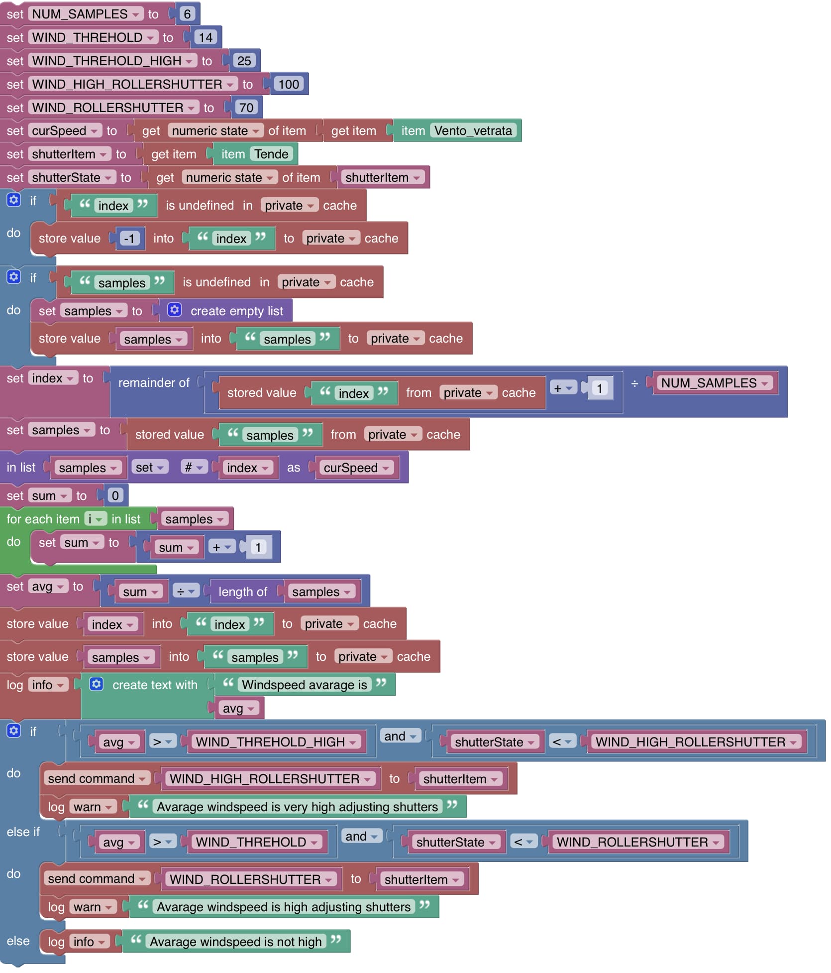

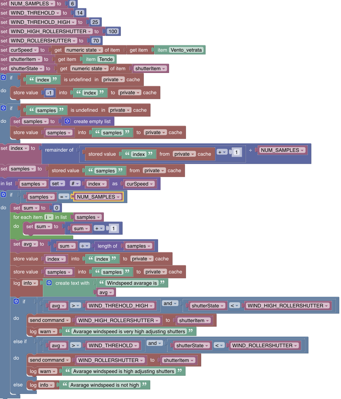

var NUM_SAMPLES, WIND_THREHOLD, WIND_THREHOLD_HIGH, WIND_HIGH_ROLLERSHUTTER, WIND_ROLLERSHUTTER, curSpeed, shutterItem, shutterState, samples, index, sum, i, avg;
NUM_SAMPLES = 6;
WIND_THREHOLD = 14;
WIND_THREHOLD_HIGH = 25;
WIND_HIGH_ROLLERSHUTTER = 100;
WIND_ROLLERSHUTTER = 70;
curSpeed = items.getItem('Vento_vetrata').numericState;
shutterItem = items.getItem('Tende');
shutterState = shutterItem.numericState;
if (cache.private.exists('index') === false) {
  cache.private.put('index', (-1));
if (cache.private.exists('samples') === false) {
  samples = [];
  cache.private.put('index', samples);
index = ((cache.private.get('index')) + 1) % NUM_SAMPLES;
samples = (cache.private.get('samples'));
samples[(index - 1)] = curSpeed;
sum = 0;
for (var i_index in samples) {
  i = samples[i_index];
  sum = sum + 1;
avg = sum / samples.length;
cache.private.put('index', index);
cache.private.put('samples', samples);
console.info(('Windspeed avarage is' + String(avg)));
if (avg > WIND_THREHOLD_HIGH && shutterState < WIND_HIGH_ROLLERSHUTTER) {
  shutterItem.sendCommand(WIND_HIGH_ROLLERSHUTTER);
  console.warn('Avarage windspeed is very high adjusting shutters');
} else if (avg > WIND_THREHOLD && shutterState < WIND_ROLLERSHUTTER) {
  shutterItem.sendCommand(WIND_ROLLERSHUTTER);
  console.warn('Avarage windspeed is high adjusting shutters');
} else {
  console.info('Avarage windspeed is not high');
2024-05-05 17:36:20.228 [ERROR] [b.automation.script.javascript.stack] - Failed to execute script:
org.graalvm.polyglot.PolyglotException: TypeError: Cannot set property "0" of null
	at <js>.:program(<eval>:21) ~[?:?]
	at org.graalvm.polyglot.Context.eval(Context.java:399) ~[?:?]
	at com.oracle.truffle.js.scriptengine.GraalJSScriptEngine.eval(GraalJSScriptEngine.java:458) ~[?:?]
	at com.oracle.truffle.js.scriptengine.GraalJSScriptEngine.eval(GraalJSScriptEngine.java:426) ~[?:?]
	at javax.script.AbstractScriptEngine.eval(AbstractScriptEngine.java:262) ~[java.scripting:?]
	at org.openhab.automation.jsscripting.internal.scriptengine.DelegatingScriptEngineWithInvocableAndAutocloseable.eval(DelegatingScriptEngineWithInvocableAndAutocloseable.java:53) ~[?:?]
	at org.openhab.automation.jsscripting.internal.scriptengine.InvocationInterceptingScriptEngineWithInvocableAndAutoCloseable.eval(InvocationInterceptingScriptEngineWithInvocableAndAutoCloseable.java:78) ~[?:?]
	at org.openhab.core.automation.module.script.internal.handler.ScriptActionHandler.lambda$0(ScriptActionHandler.java:71) ~[?:?]
	at java.util.Optional.ifPresent(Optional.java:178) [?:?]
	at org.openhab.core.automation.module.script.internal.handler.ScriptActionHandler.execute(ScriptActionHandler.java:68) [bundleFile:?]
	at org.openhab.core.automation.internal.RuleEngineImpl.executeActions(RuleEngineImpl.java:1188) [bundleFile:?]
	at org.openhab.core.automation.internal.RuleEngineImpl.runRule(RuleEngineImpl.java:997) [bundleFile:?]
	at org.openhab.core.automation.internal.TriggerHandlerCallbackImpl$TriggerData.run(TriggerHandlerCallbackImpl.java:87) [bundleFile:?]
	at java.util.concurrent.Executors$RunnableAdapter.call(Executors.java:539) [?:?]
	at java.util.concurrent.ScheduledThreadPoolExecutor$ScheduledFutureTask.run(ScheduledThreadPoolExecutor.java:304) [?:?]
	at java.util.concurrent.ThreadPoolExecutor.runWorker(ThreadPoolExecutor.java:1136) [?:?]
	at java.util.concurrent.ThreadPoolExecutor$Worker.run(ThreadPoolExecutor.java:635) [?:?]
	at java.lang.Thread.run(Thread.java:833) [?:?]
2024-05-05 17:36:20.238 [ERROR] [internal.handler.ScriptActionHandler] - Script execution of rule with UID '97ba6d2f35' failed: org.graalvm.polyglot.PolyglotException: TypeError: Cannot set property "0" of null

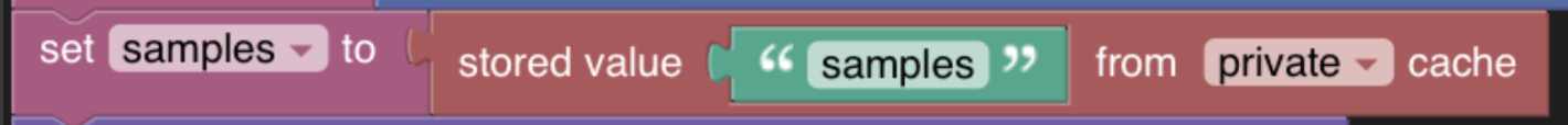

Hi Rich I have corrected I doble check everything error still in the logs..
Please help
thanks
You haven’t corrected the problem. The block still says “store value samples into index to private cache” in the screenshot of the blocks. The key we store the samples under in the cache needs to be “samples”, not “index”.
Eureca Rich now works!!!
I just copied this rule and there was the error there.
Now correct in this

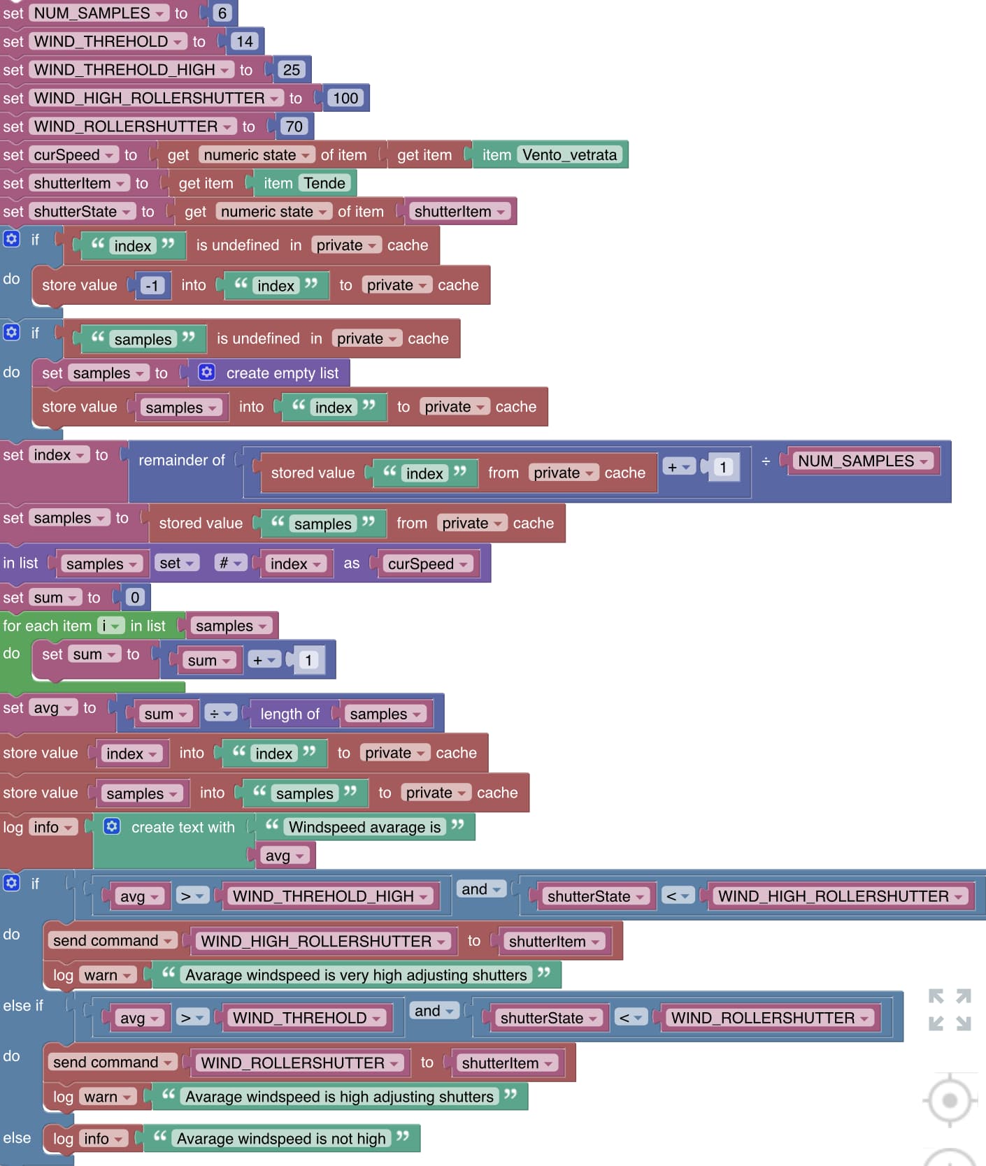

NUM_SAMPLES = 6;
WIND_THREHOLD = 14;
  samples = [];
sum = 0;
  sum = sum + 1;
} else {
Thank you indeed to point me in the right direction.
Keep studying
Cheers
Rule is working now.
But it calculate always the same average even if move manually the sensor more than 1.2 average so the roller doesn’t go up
2024-05-05 18:33:02.234 [INFO ] [openhab.event.ItemStateChangedEvent ] - Item 'Vento_vetrata' changed from 36.29 km/h to 27.29 km/h
2024-05-05 18:33:02.237 [INFO ] [nhab.automation.script.ui.97ba6d2f35] - Windspeed avarage is1.2
2024-05-05 18:33:02.238 [INFO ] [nhab.automation.script.ui.97ba6d2f35] - Avarage windspeed is not high
2024-05-05 18:58:42.473 [INFO ] [nhab.automation.script.ui.97ba6d2f35] - Windspeed avarage is1.2
2024-05-05 18:58:42.475 [INFO ] [nhab.automation.script.ui.97ba6d2f35] - Avarage windspeed is not high
2024-05-05 18:58:43.471 [INFO ] [openhab.event.ItemStateChangedEvent ] - Item 'Vento_vetrata' changed from 6.61 km/h to 3.89 km/h
2024-05-05 18:58:43.475 [INFO ] [nhab.automation.script.ui.97ba6d2f35] - Windspeed avarage is1.2
2024-05-05 18:58:43.476 [INFO ] [nhab.automation.script.ui.97ba6d2f35] - Avarage windspeed is not high
Avarage is caluculated any second now
This suppose to be the high wind case and the roller supposed to roll up
It seems 6 samples is very sensitive and avg is calculated immediately
Do I have to increase the samples?
The rule runs once per second.
The first time the rule runs after it’s loaded, there is only one sample so that becomes the average.
The second time there are two samples so the average is the average of those two samples.
This continues until there are NUM_SAMPLES samples. From that point the oldest sample gets replaced with the new sample, keeping a moving average of the most recent NUM_SAMPLES samples. A new average is calculated every second.
If you want to change this behavior this is a great opportunity to see if you understand the code. You can make it wait until it has NUM_SAMPLES samples before it tries to calculate the average. Add an if after curr speed is added to the samples list to only run the rest of the rule when the length of the samples list is NUM_SAMPLES. There are example of all the blocks you need already in the rule.

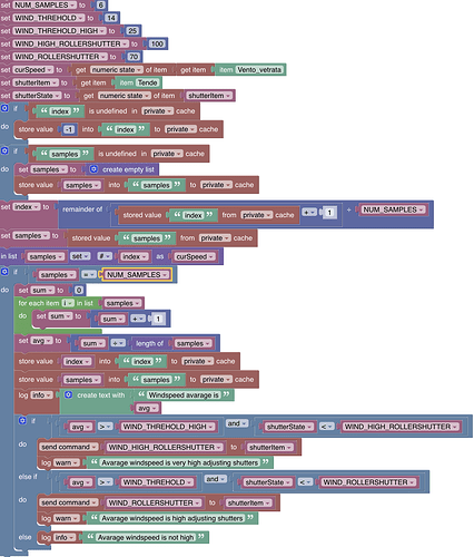

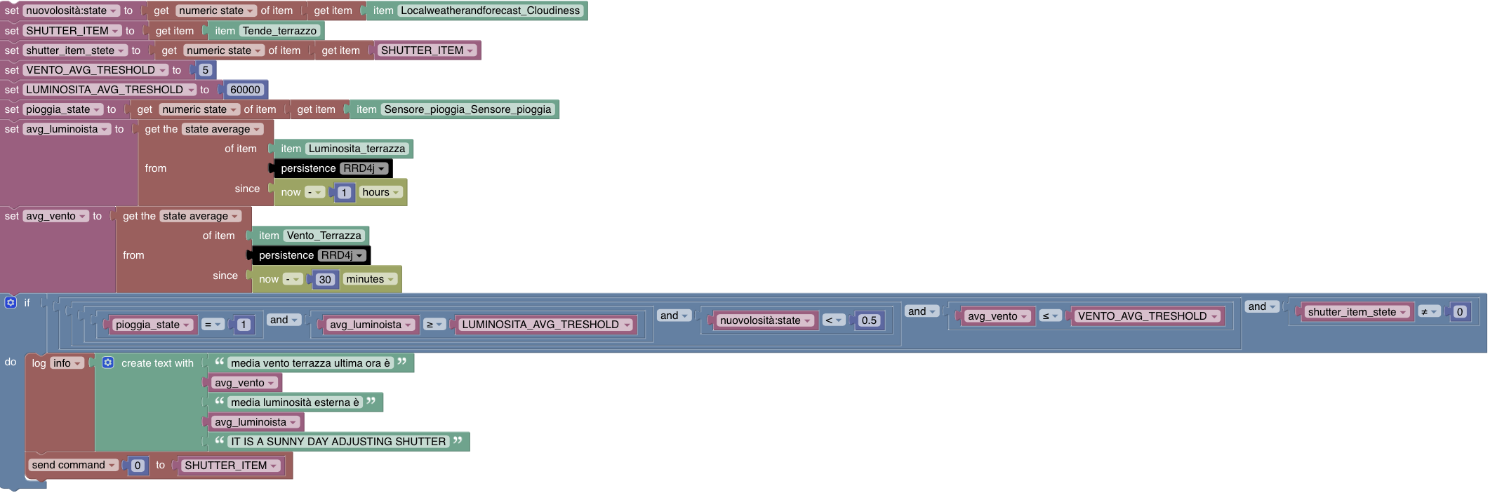

Hi Rich tried in this way as you suggested
Can it work?
The best way to answer that question is to try it and see. You don’t need us to tell if the rule does or does not do what you expect it to.
From what I can see it should work. At least you added the if statement exactly like I described. Whether that works…I’m not a computer. I can say that it should work but actually running the rule and observing will tell you whether it does work.

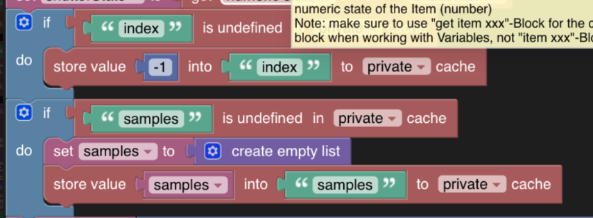

I have changed in this (also tried lenght=) and the commands doesn’t start any longer.
I don’t understand in your rule where the rule is state to run every second and how calculate how many averages it takes.
Belive is too difficult to me cope with this.
justanoldman’s code works similar as I expected so I forced to move in that direction and playing to learn a bit of coding with Rich’s one.
Cheers
That’s the rule trigger. You must set the trigger to a time based trigger using the cron expression from above as described above. That runs the rule every second.
That’s not part of the Blockly code at all. That’s the rule trigger that does that.
Regardless of you using the sample approach I gave or the approach @rlkoshak offered this statement remains the same.
What I am saying is identify each piece of the script and what it is doing I keep linking you back to a site that offers clear and easy explanations and samples as well as try it yourself. It is one of many sites that explain how all these script pieces work I am sure there are others that may be in a different language or teaching approach that may suit you better but I really recommend you spend some time on one of them to avoid getting frustrated and giving up.
“Nothing is too difficult” if you are willing to put real effort into learning it.
Till you understand how all the pieces fit together and work by their selves you will struggle trying to change anyone’s examples to fit your needs.
Thank you Rich so I have to add a trigger events as now I set as trigger the wind sensor changing as trigger event to start the rule.
I do not understand in the rule the sum
Why for each item you set the sum plus 1?
OK, the cron trigger should be the only trigger.
:person_facepalming:
Good question, it shows you are paying attention.
Total bone headed mistake on my part. It’s supposed to be the variable i, not the number 1. The color difference should have been clue enough to me but apparently it wasn’t and my brain was just inserting the correct answer instead of what’s actually there.

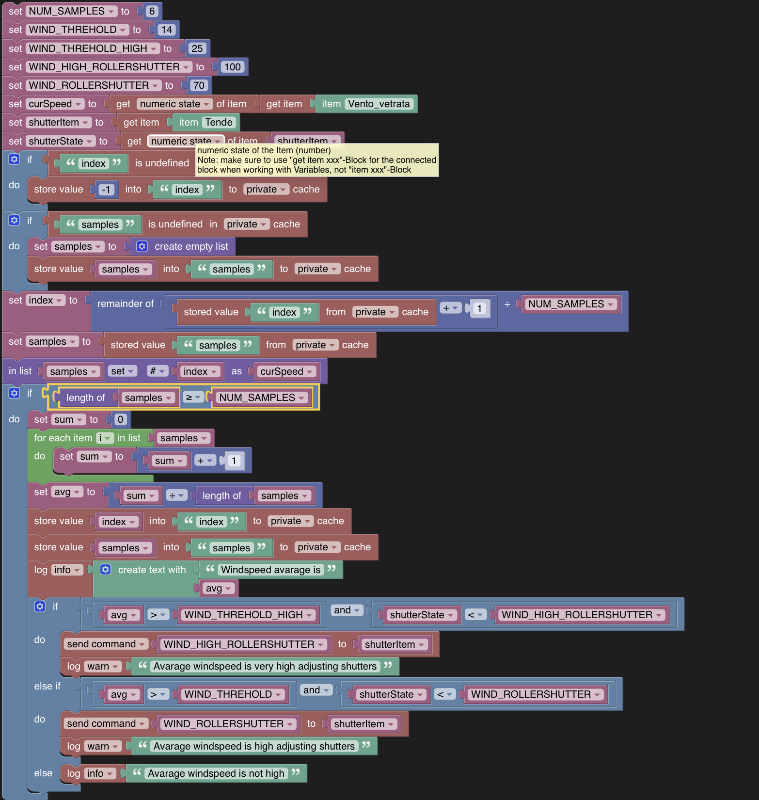

Finally changed math and set as trigger the cron condition of every second it seems works as expected!! My logs are flooded

  1. pull the value of “index” from the private cache. So we have 0 right now.
  2. Add one to the value, so now we have 1.
  3. Finally we take the remainder of 1/3 which is 1.
And now we store the current windspeed in the “index” slot of the list. The list now has two samples stored, one at 0 and one at 1.
The rule runs again and just like before the initialization blocks are skipped and the tricky line of code runs.
  1. pull the value of “index” from the private cache. So we have 1 right now.
  2. Add one to the value, so now we have 2.
  3. Finally we take the remainder of 2/3 which is 2.
Now we store the current windspeed in the “index” slot of the list. The list now has three samples stored, one at 0, one at 1, and one at 2.
The rule runs to completion and triggers again. Again we skip the initialization blocks because we already have values stored for “index” and “samples”. The tricky block runs again.
  1. pull the value of “index” from the private cache. So we have 2 right now.
  2. Add one to the value, so now we have 3.
  3. Finally we take the remainder of 3/3 which is 0. We have circled back to 0.
Now we store the current windspeed in the “index” slot of the list. This causes the oldest sample to get replaced with the current sample. That means that the sum that happens later will always be the sum of only the NUM_SAMPLES most recent windspeed samples (in this example 3).
Hopefully you can see why we therefore need to keep both the “index” and the “samples” in the cache. One is to keep track of where the oldest sample is in the list so we can replace it and the other is to keep the list of samples itself.
What do you mean by “flooded”? Which logs? Given the most recently blocks posted above, you should get no more than one log statement per second in openhab.log.
Unless you delete or disable the rule (the circle with ll in the middle next to the triangle play button) it will run every second as long as OH is running.
This rule probably takes no more than 100 msec to run, most likely closer to 20 msec. And what it does in that small fraction of a second is neither RAM nor CPU intensive. This rule will have negligible impact on your system. You could have dozens of these rules running and probably couldn’t measure the impact they all combined would have on your system.
Running this rule is not going to be an issue.
But let’s say you want to be super efficient for the practice. You could add another rule that triggers when the rollershutter changes. You can add a Blockly script action here that tests to see if the rollershutter is > 10 or not. If it’s less than 10 we don’t care what the windspeed is so disable the cron triggered rule (there’s a block for that). If it’s greater than or equal to 10 enable the cron triggered rule. Then the rule will only be calculating the windspeed average when it matters.
There’s really no compelling reason to do that but it could be a good learning exercise.
(Note: you wouldn’t want to add a condition to check the rollershutter to the cron triggered rule because then the values in the cache will get stale. By disabling and reenabling the rule, that causes the cache to get cleared so when it’s reenabled it starts with “index” == -1 again and an empty samples list.)

This is supposed to run on cron expression every hours between 11 and 19.00 only between April and October
Made some progress thanks for
