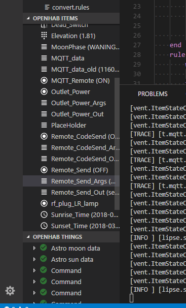

Make sure the items are instanciated by looking in the openhab console or VSCode.
Do you use VSCode and the Openhab plugin?
And my setup.
