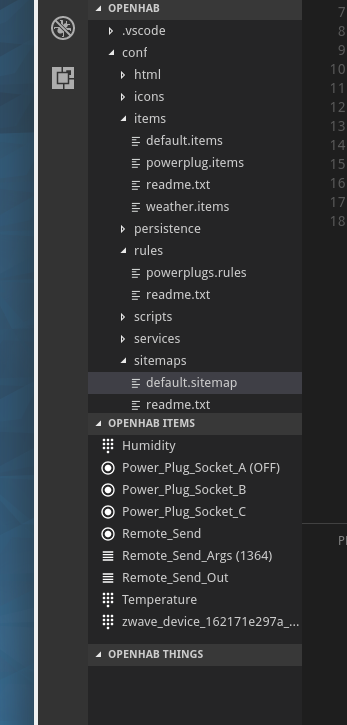

Make sure the items are instanciated by looking in the openhab console or VSCode.
Do you use VSCode and the Openhab plugin?
grafik
And my setup.
Hi Josar.
very nice of you responding to my post! A lot of questions, I will answer them as good as possible.
  1. full path /home/pi/opt
    My path is “/opt/433Utils/RPi_utils/”. Both users (openhabianpi and openhab) can run the command “/opt/433Utils/RPi_utils/codesend 1361” without any error and the powerplug reacts as expected.
  2. A null error mostly says one used element is not initialized.
    I changed all files in the order exec.things, powerplug.items, powerplugs.rules and default.sitemap.
Afterwards I did a “sudo reboot” in an ssh session. After reboot I started vscode and all powerplug related items are instantiated
