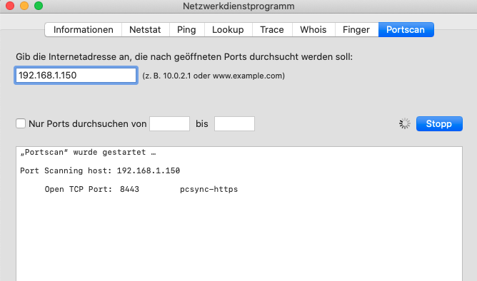

Meanwhile I port scanned the Samsung AC unit with the following result:
With command openssl I am also able connect through this port:
[22:02:39] openhabian@openhab:/usr/share/openhab2/addons$ openssl s_client -connect 192.168.1.150:8443 -cert cert.pem

Update from 05.04.2021:
So the port is also changing of my 2021 Samsung Windfree unit. Today it´s running on port 1857.
So any chance to use this binding even with changing ports or is it waste of time?
