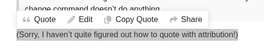

(Sorry, I haven’t quite figured out how to quote with attribution!)
If I am sending to a single device with a simple state machine that requires ordering of commands through a reliable transport, there’s nothing there to indicate that the timing of the commands matters. If you complicate it by making it multiple devices or an unreliable transport, then yes, timing matters, but I was trying to understand your generalization. I think you were just making a broad statement taking complex scenarios into consideration, while I was trying to understand if there was something about the event bus that I was missing.
Highlght the text and a pop-up appears:
