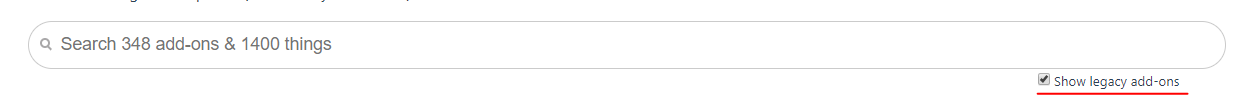

If you click on MuckiBude what happens?
There is a setting in PaperUI called “Show Legacy 1.x Bindings” in the Configuration → Services section. Depending on what package you originally chose after first installing OH, that option was probably unchecked.
In the docs, there is a checkbox to show the legacy bindings under and on the right side of the search box.
In general, OH encourages users to use the 2.x versions of bindings instead of the 1.x versions where there are two versions. So they make you deliberately choose to see and have available the 1.x versions. I’m ambivalent about the decision. I don’t like hiding data but this does keep new users in particular from choosing versions of bindings that are no longer updated or maintained.
