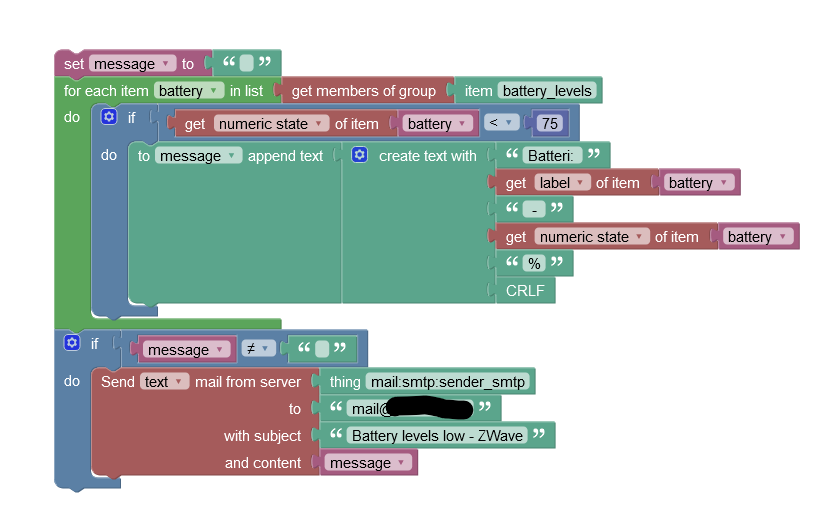

Thank you all very much for your help. I now managed to get it working in dsl:
val mailActions = getActions("mail","mail:smtp:sender_smtp")
val msg = new StringBuilder
var triggertDevices = battery_levels.members
triggertDevices.forEach [ i |
if (i.state !== NULL) {
if ((i.state as Number) <= 75)
msg.append(i.name + ': ' + i.state.toString + '%\n')
logInfo("low_bat-send_mail.rules","Lavt batteriniveau på " + i.name + ": " + i.state.toString + "%")
if (msg != "") {
val success = mailActions.sendMail("mail@xxxxxx.dk", "Batteri advarsel - openHAB: -" , msg.toString)
and in Blocky
The Ruby script though does absolutely nothing - and no errors in the logs

Ahhh and now I also managed to get the Ruby script running:
low_battery_items = battery_levels.members.filter(&:state?).select { |i| i.state < 75 }
if low_battery_items.any?
message = low_battery_items.map { |i| "#{i}: #{(i.state).round}%" }.join("\n")
message = "Batteri advarsel - openHAB:\n#{message}"
logger.info(message)
things["mail:smtp:sender_smtp"].send_mail("mail@xxxxxx.dk", "test", message)

In the Ruby script the < 0.75 did not trigger - it must be <75 and then a subject string in the mail was missing.

Well now you know how to do it in all 4 languages (see the code generated by blockly in javascript)
