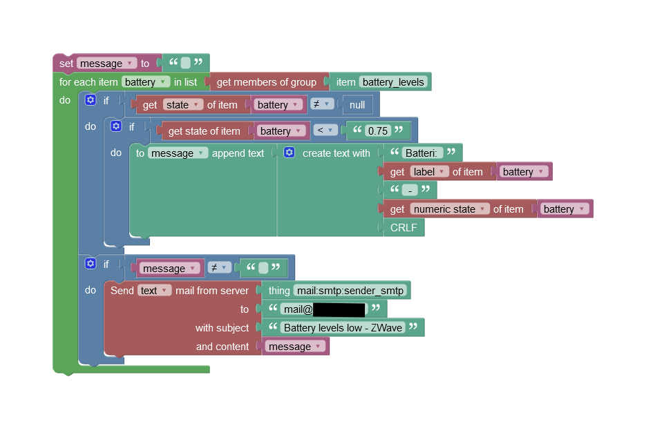

Ahh yes - well I have now build this:
blocky
But I get this error in openhab.log when I run it ??
“2024-09-08 18:20:58.280 [ERROR] [internal.handler.ScriptActionHandler] - Script execution of rule with UID ‘send_mail_on_low_bat_blocky’ failed: org.graalvm.polyglot.PolyglotException: TypeError: invokeMember (getItem) on org.openhab.core.internal.items.ItemRegistryImpl@1d09e97e failed due to: Cannot convert ‘[object Object]’(language: JavaScript, type: g) to Java type ‘java.lang.String’: Invalid or lossy primitive coercion.”

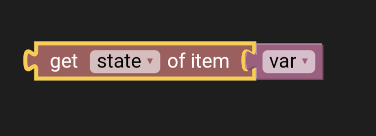

try the
Screenshot_20240909-064744
in both if-clauses and tell me what you get.
I think the problem is here:
if battery.state <  "0.75"
You cannot compare two strings in this way. They need to be converted to numbers like this:
if battery.numericState <  0.75
See documentation how this can be achieved with blockly.
Just as a side note, the first if-loop is irrelevant as a numericState which is < 0.75 is always not null.
Not sure if this is intended but your script will in worst case send as many separate emails as you have battery items. And each null item will send the message of the last non-null item again.
Take a look, you just need one single if-loop whithin forEach-loop.
Another recommendation could be to add a filter expression to your forEach loop so that you are only dealing with items < 0.75 in your loop.
