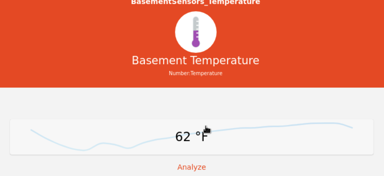

Have you worked out the Semantic Model yet? I’d be willing to bet that most of those charts are already dynamically generated. All Items that are queryable from the DB will be dynamically chartable individually. You can even put an outline of the chart behind the Item’s card.
When you put your Items into a Model a chart with all the Items will be available for all the Items of a given Property type automatically by clicking the “Analyze All” button at the bottom of the card.
The Items shown and the time period can be dynamically adjusted. Changes to the chart config can be saved as a new Chart page.
You can also create custom widgets with a custom Analyze All function to dynamically generate charts in that widget. In short you can add an “Analyze Item(s)” action to any widget which will add that “Analyze All” button and open a dynamically generated chart with the configured Items when clicked.
