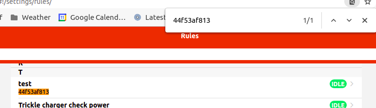

I installed a program called jq on my Linux OS and I run this command:
cat /var/lib/openhab/jsondb/automation_rules.json | jq . |less
It gives output like below and I search for the item or whatever.

In the above example the 44f53af813 is the rule id and I just use ctrl-f to search on the web page and ctrl-v to paste the 44f53af813 into the search to fine the rule.
