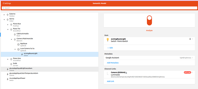

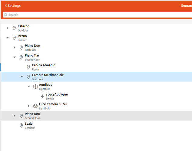

Sorry I try some tests but something looks not clear.
For example why the three point are not inside LuceApplique also if I define as point of luce applique?
//SECONDO PIANO
//CAMERA MATRIMONIALE
//APPLIQUE
Group  gLuceApplique "Applique" (gApplique) { ga="SpecialColorLight" [ colorUnit="kelvin", colorTemperatureRange="2600,6999" ] }
Switch sLuceAppliquePower <light> (gLuceApplique) ["Switch"]  { channel="deconz:colortemperaturelight:00212E02482D:7cb03eaa00a95bf503:brightness", ga="lightPower"  }
Dimmer gLuceAppliqueBrightnessItem <light> (gLuceApplique) ["Control"] { channel="deconz:colortemperaturelight:00212E02482D:7cb03eaa00a95bf503:brightness", ga="lightBrightness" }
Number gLuceAppliqueColorTemperatureItem <light> (gLuceApplique) ["Control"] { channel="deconz:colortemperaturelight:00212E02482D:7cb03eaa00a95bf503:color_temperature", ga="lightColorTemperature" }
and also why if I put a switch inside Luce Camera Su Su that is in the location Camera Matrimoniale, from location view I see nothing? In the @rlkoshak posts appear in the card the light on for example?
Thank you!

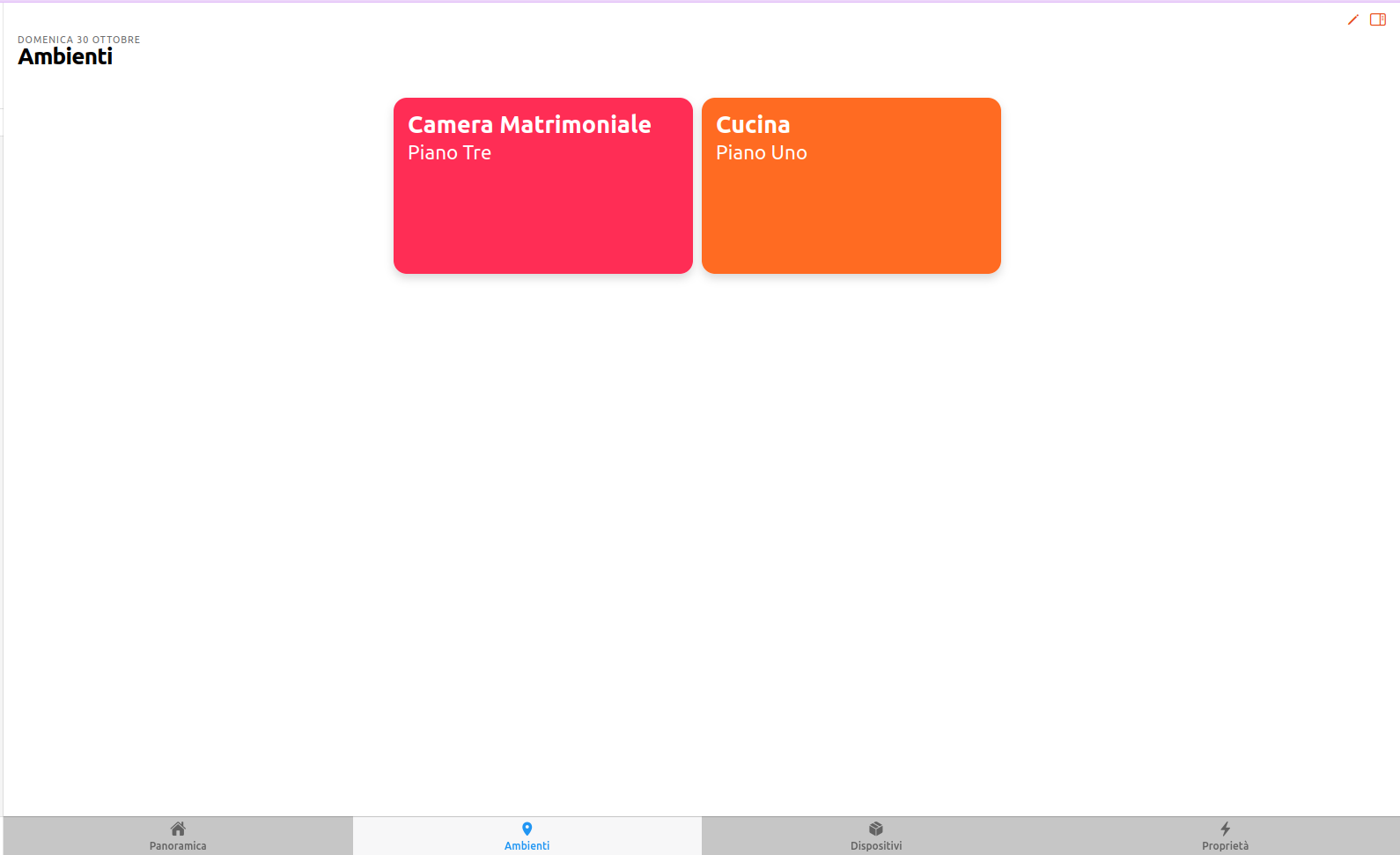

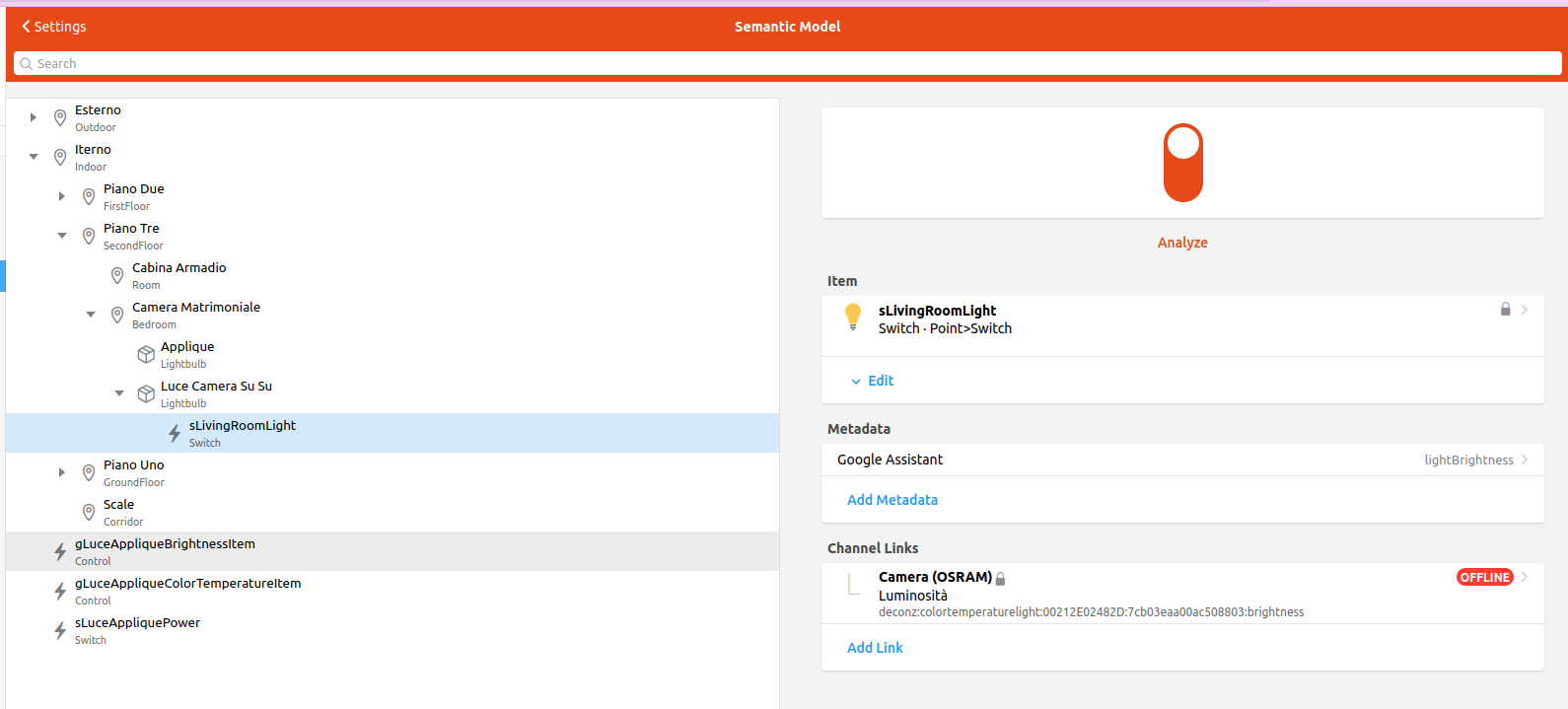

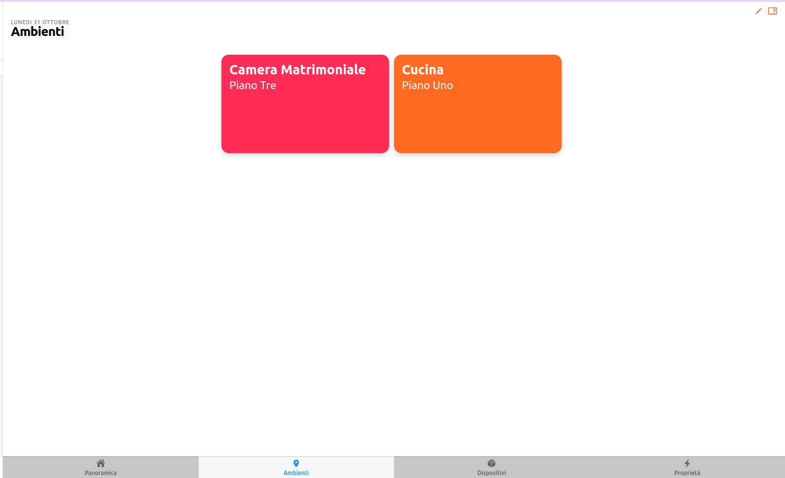

Sorry guys,
I try to delete the contents of the points.items file, save and write again and looks like works, but still in the location pages I don’t see for example the badge of the light…how I can solve it?
If you think I have to create a new post with a new more pertinent title I will do it! Thank you.
You have two different tabs. One for locations which shows the different ‘top’ level locations and you have an other tab which shows the badges by equipment category e.g. light. There you should find your lights.
Sorry @Wolfgang_S , according to @rlkoshak example here A Deep Dive into the Semantic Model, he is able to see the status of the points in the Location cards and me no :smiling_face_with_tear: . How can I also realixe it?
Thank you.
From Getting Started Tutorial:
  • A Point is not a Group, but represents any other type of Item and is usually linked to a Channel.
  • A Property is an additional tag on a Point Item that indicates what sort of point it is. For example, a thermometer might be a Point of type Measurement with a Property of type Temperature.
and most specifically from the Badges section:
Badge Type Equipment Point Property
Lights Status Any Control, Switch Light
You’ve not applied any of the Property tags to your Items and the table shows you must have a Light property tag.
